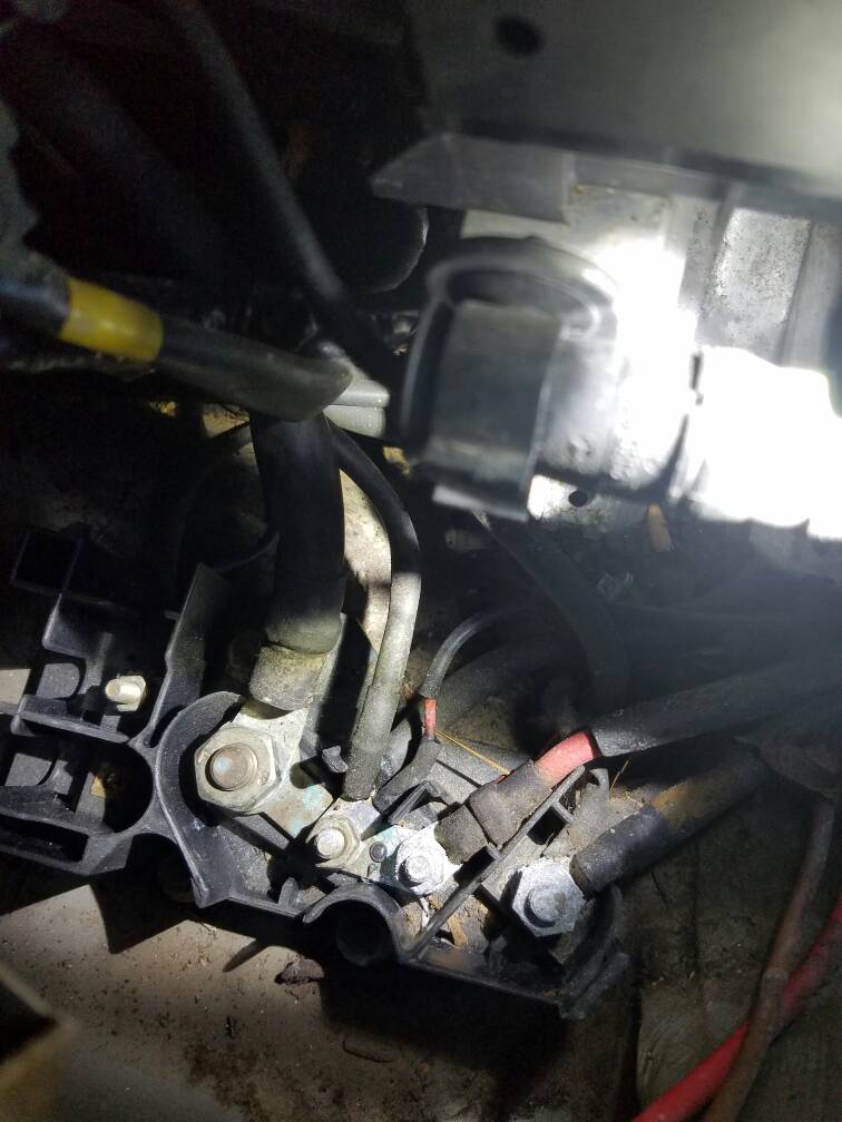

So is there an interchange module or something that could have become corroded?
Several key electrical areas in this car have light corrosion on them from 5 years of being parked outside.
I cleaned up the fuse box but right now every single terminal is corroded.
There is some bundle of wires all connected to this rectangular terminal in the left of the drivers side footwell, that is pretty corroded.
The main electricity block from which the wires reach the alternator is a bit corroded too.
But these have been like this from before all the shutdown issue began. Before i just had this heavy misfire. Never shut down.

Man. A few months ago I tried to correctthe corrosion issue by using a method I saw in several places online. Using baking soda and vinegar etc.
I just realized how much more corrosion this has caused. Both battery terminals have corrosion. Fuse box. And the terminal block where the lower wiring harness connects to behind the computers in engine bay.
More work foe me to do when Im so short on time
Sent from my SAMSUNG-SM-G935A using Tapatalk
Ooh! You have a pH battle going on. The Baking soda solution is better used to neutralize spilled battery acid corrosion (as in the E500E rear fender well battery box). Vinegar (although a versatile all-purpose cleaner) is a mild acid & better used for glass cleaning.
You can pick up a neat battery terminal cleaner/anti-corrosion kit at any auto parts store. They work great.
For contacts, you are much better off using a product like NAPA CRC QD Electronic Cleaner.
You definitely don't want your terminals & contacts getting crusty. That can compound the problems you are currently experiencing.
