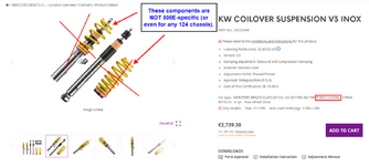

I am curious why KW suspension has a alternative shock kit for the W124 when the purchase selection indicates SLS..
They have a video on W201 suspension, but nothing but a teaser pic on line about the 500E.
I wonder if they created a hydraulic compatible solution for our chassis..
I recoil (pun intended) in horror any time I see "coilover" for the 124/201/129 chassis. Thankfully, the KW design is not a coilover. It's simply replacement dampers/springs with a threaded, adjustable spring perch to allow variable ride height. Twiddling the threaded spring perch allows more finite settings vs the factory rubber spring pads. I really like the adjustable compression & rebound damping, AND the separate high-speed and low-speed damping design. I wish they would sell the front struts separately from everything else. I don't really need fancy spring adjusters. It does look like a very nice kit for standard, non-SLS applications.
No, they have not created a hydraulic / SLS solution. Their website is BAD. More like terrible. It shows generic, stock-photo coilovers in the product photos on the page that is specific to the 500E! WHY? The company is willing to invest in engineering a nice damper set but too lazy to have application-specific photographs on their vehicle-specific webpage? :facepalm: :doh:
Thankfully, KW has good installation instructions which show the actual components being installed on a 500E. The SLS is disabled and lines are blocked off. The SLS valve is locked into bypass position. Couple of interesting tidbits, they require minimum 5mm air gap between front strut and tire sidewall. And, the recommended minimum ride height (fender lip to wheel center) is 13.0" front, 13.25" rear... a bit below what GSXR has been saying for decades as the absolute lowest you'd ever want for street driving.
Scroll near the end of the PDF for on-car installation photos:
This is what I'm complaining about on the KW website. The items shown in the photos are not what you get in the box for a 124 chassis KW application. The rear shock may look similar to what's shown, but there's no way to tell for certain.
