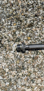

With all the discussion about extractors, I decided to look around and see if I could add more to my toolbox. One of the hardest things for me has been to drill out the center of a broken M5 or M6 bolt thread. None of my punches seems to be capable of marking the center well enough to keep the drill bit from walking all over.
I ordered this Rennsteig [Knipex / Germany] extractor which uses the narrow pointed end as a center punch and the extractor further down:
I also ordered some Lichamp 1/8" cobalt drill bits that are triple-fluted, hoping that they will be able to stay centered and cut into the factory bolts. Lichamp 1/8" HSS Cobalt Drill Bits 10PCS with Three Flute for Hard Metal, Hardened Stainless Steel and Cast Iron: Amazon.com: Industrial & Scientific
Now I just need a broken bolt to test it on. Thanks to @gsxr I found some more info on this tool from Knipex: https://www.knipex-tools.com/products/rennsteig/
