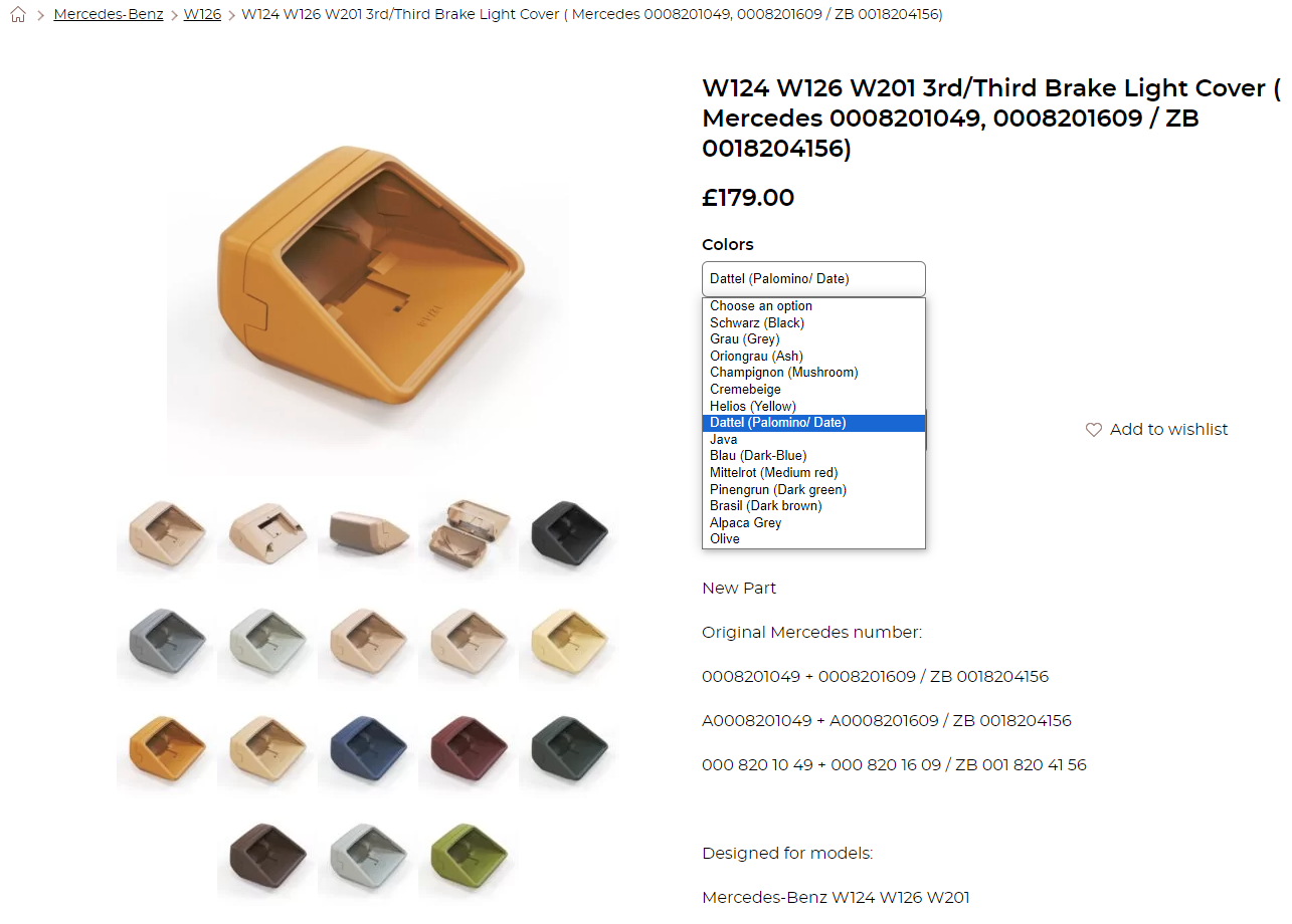

1994 interior code xx4 would be Saddle, which is slightly darker than Palomino.
Most likely you'll need to find a used one of any color and paint it to match your interior.
If the old one is not completely destroyed, your best option is to repair it.
I’m good, thank you. I purchased a nice aftermarket one from Ocoto which was in the color I needed.
This item? The Palomino color will be close, but not quite right for your 1994 model with Saddle interior.
It was nearly the identical color and good quality but lacked the proper reflector and mounts. It had a makeshift foil reflector. Still, far better than any salvage item I could find.
