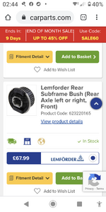

Hi everyone I am new on here, I am looking and been looking for a rear SUB FRAME BUSH INSTALLER REMOVAL TOOL for my mercedes-benz 190e 1989 w201, I can not find the tool for the job can someone help me out or can someone put me in touch with someone how can help me out, thank you so much for taking the time to Reed this post thanks again Ian 👍

If it really is a wheel bearing tool, the price is quite good... but you still need other tools to remove the hub first.
