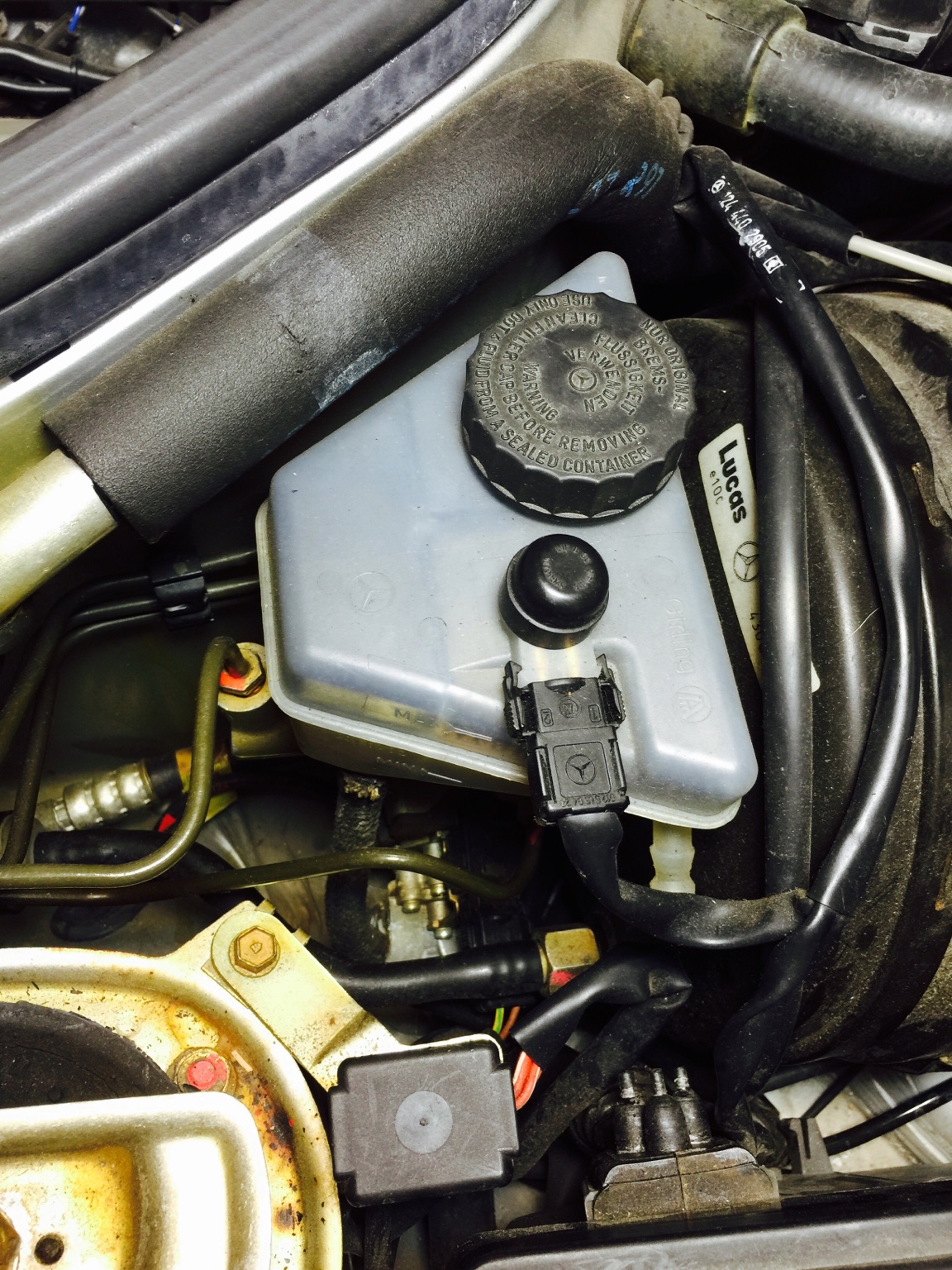

would like to post images of the set up I have around the brake booster and vacuum lines, but can not
figure out how to upload images

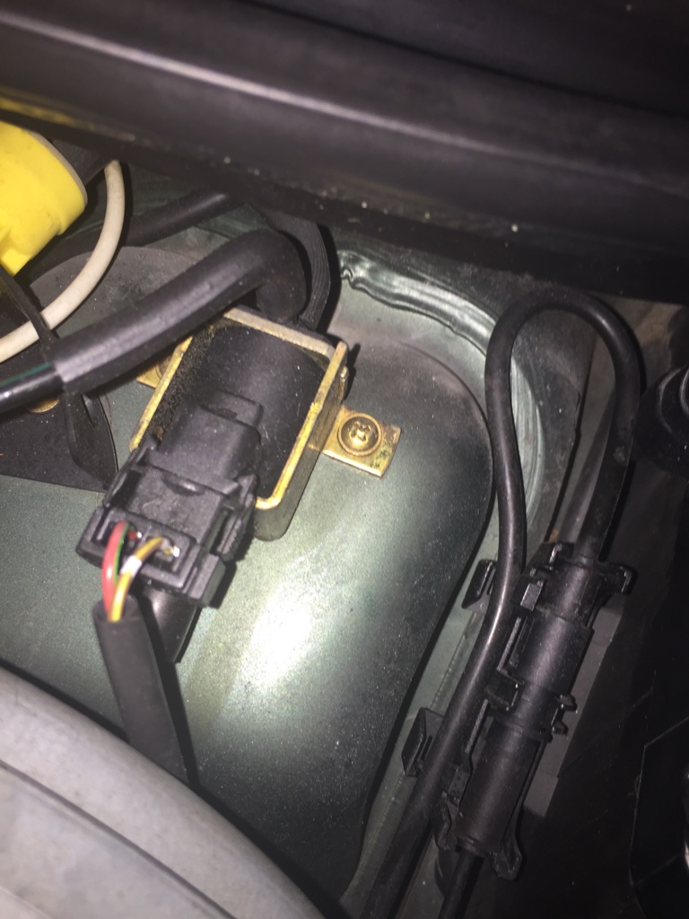

The yellow is a check valve - one directional.
Which one specifically? This?
Is that the switchover valve? The one you have your index finger on?
I do not have anything attached to it.
The vacuum line is color coded black/green.
Yes, that is the switchover valve. Should be vacuum source input and the black/green tube output, to the transmission.
