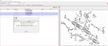

I've searched high and low and can't seem to find this information. Can you guys tell me what steering ratio the W210 racks came with on RWD cars? Are the AMG racks different from those found on an E420?
I can't answer the question about the ratios.
However, there is a "Sports chassis" steering rack with a different part number, unique to models with option codes 653 / 655 / 676.
