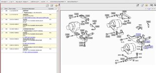

Here is what my EPC came up with, the same bolts for early and late models.
