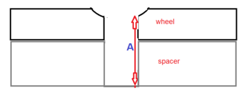

I think best way to get this info is measure the protrusion of the factory bolt on the back of factory wheel, and then, with the new wheel and spacer attached to the new wheel, measure the depth from the lower edge of the ball seat of the new wheel to the end of the spacer (A) and add whatever the protrusion of the factory bolt from the factory wheel
