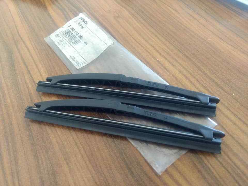

Re: WTB: 94-up Headlight wiper blades 124-820-02-45-67
Works for both facelifted and pre-facelift W124s.
You need to swap over the stainless-steel strips, and use the old wiper as a template to cut.
Bosch Z901
:-) neil

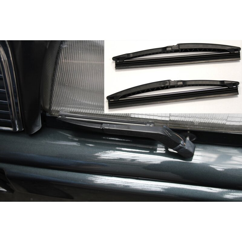

I have no idea if they are similar but maybe some period correct (740,850 etc) Volvo headlight wiper inserts would work
Reproductions available now from Germany, €90/pair, plus S&H.
"The wiper blades with the OE number Mercedes-Benz / Bosch / SWF A1248200245 are reproduced by us in the highest possible quality and are of the same quality as the original. "
IIRC someone reported issues with those... they appear to be different than the originals. :scratchchin:

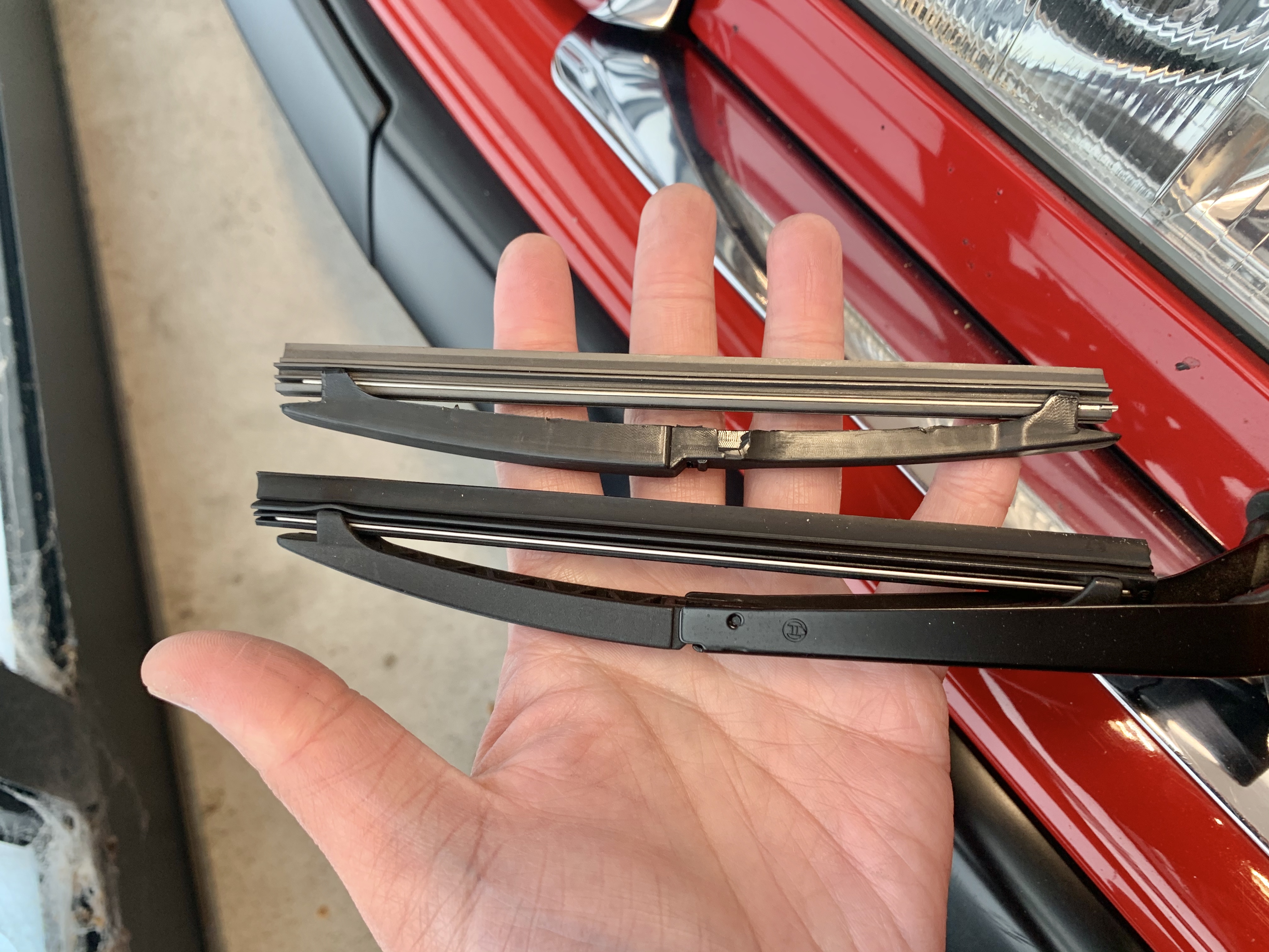

I received them finally after a long long long C19 shipping delay. I don't know if these are OE or not because they did not come in MB packaging, but they appear to nearly exactly the same as the MB Euro wiper blades on my car (previous owner changed my headlamps / wipers to MB European units back in 2014/2015 timeframe). Same size, same length, etc.
BTW the seller is a super stand up guy. After waiting a whole month past initial ebay estimates, I contacted the seller and he refunded my money. He didn't have to --- the package was had been stuck in NY for many many weeks. A couple weeks later, the package arrived. I sent the money back to the seller. Two thumbs up.
On closer inspection, these do not appear to be original, but for my own tastes they would be a reasonable replacement copy for the day when my original headlight wiper blades wear out .... maybe in 20 yrs?
4EA67915-3C70-49D8-A7D3-37F94AD38CA0.jpeg873EE1E1-01CB-48FB-9B2E-FBB6F7418D74.jpegD978E5E7-8023-4B4D-AC82-C62BD986135E.jpeg3D7D359B-5F22-4DDA-83EE-39C20A188019.jpeg
Thanks, Jlaa! The listing indicates they are reproductions, but these are pretty good repops.
It was either a different seller, or an earlier product from the same seller, that was different. For anyone who needs 'em, these appear to be a viable solution.
:deniro:
View attachment 108272View attachment 108273View attachment 108274View attachment 108275

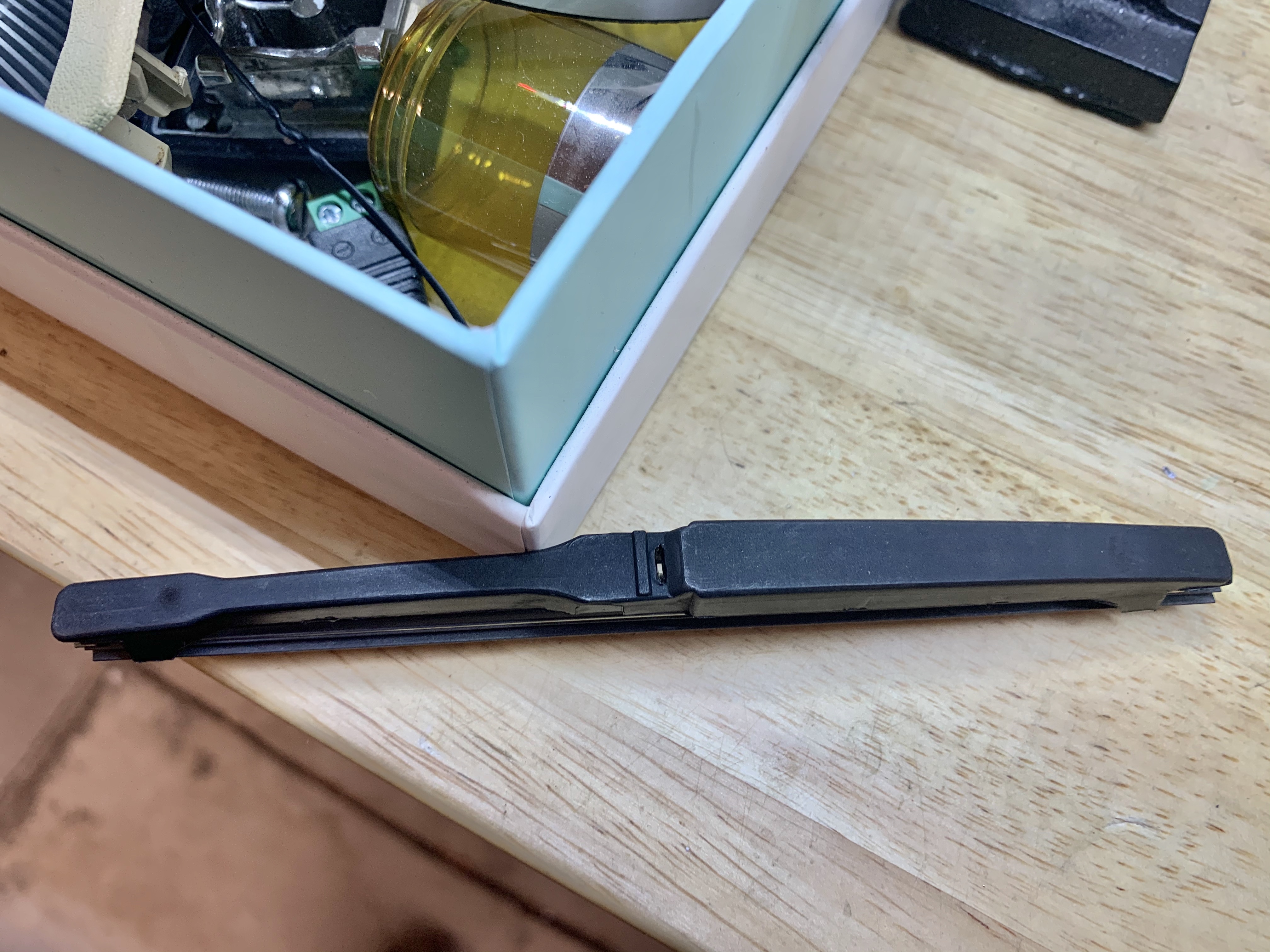

For the wipers that I just sold, I had a new pack of Bosch 18" wiper blades (just the rubber inserts, not with the metal frame) in my parts stash, which I'd gotten as extras long ago for a white 1995 E320 wagon that I had once owned. Cutting the inserts to the correct length was easy. You have to make sure you have the rubber blade inserts that have the small notch on one end, which helps retain them in the arms and keep from sliding out.
I just made 2 over the past weekend with 10" Bosch Spectrum DirectFit R1001s for my new E420....my O'Reilly store didn't have just the refills but the 10" rears were on sale for $7.99 with the frames.
:blink: Of course, not a day later after I did this I found my missing stash of new OE MB ones in the bags....I think I'll list them on eBay and have an xtra nice Xmas!
