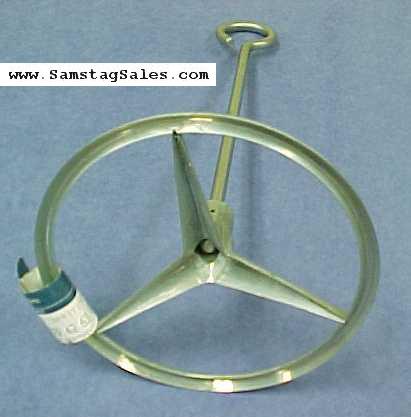

MB used to make a special tool for painting hubcaps, a metal piece that covered up the tri-star in the center and allowed you to paint the rest of the cap as you needed to. In effect, it "masked" the MB star. These went out of production about 10-12 years ago, but good MB body/paint shops that have been in business for a while will have them. The MB part number for this is (was) 115 589 42 63 00.
They say they still have it here ....
http://www.benzpartswholesale.com/OEMParts/mercedes-benz-137/1/115589426300.html
Couldn't you just get an old hubcap, die grinder or Dremel tool as well as a long threaded rod and make a mask......
Ron
It's still on the MBNA price list, so it shows at parts.com and other places as well. However if it's NLA, your order will be cancelled. You MUST contact an MB dealership, or the Classic Center, and specifically ask them to check stock in both USA and Germany.

I just checked with Tom, here is his response LOL .....
Hi Karl,
I always wanted to use one of those for a branding iron for my wife’s horses (only 1 left now). These haven’t been available for around 20 years. They never really worked all that well either. We still use a layer of masking tape and an exacto knife to get that precision edge. Lots of work but well worth the end results. Happy New Year!!!
Kind regards,
Tom Hanson
Supervisor, Parts Operations
Mercedes-Benz Classic Center USA
You can mask it with tape, that's how a lot of folks do it.
