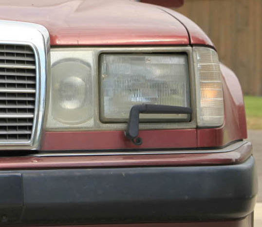

I have a pair of original lights but the lens cracked in delivery, if I bought lenses only after market would they not match? Color? Or be total garbage?
Photos would definitely help!! If it's the glass cracked as Justin says, that's different.
:neeed:
Photo above shows the plastic surround cracked... part numbers in post #4 would fix it.
But first, what the heck is going on with the headlight wiper? The shaft is supposed to come through the "half moon" hole at the bottom of that photo. Did someone install different/wrong headlight wipers? That is REALLY weird.
Photo attached below shows a stock setup.

Thank you guys for the thoughtful help, gsxr your right and believe it or not I just left mb of brooklyn and have the part bought and on its way already, as for the wiper thing you mentioned its disassembled right now I'll put it back when the lens comes lol damn your eye is GOOD
