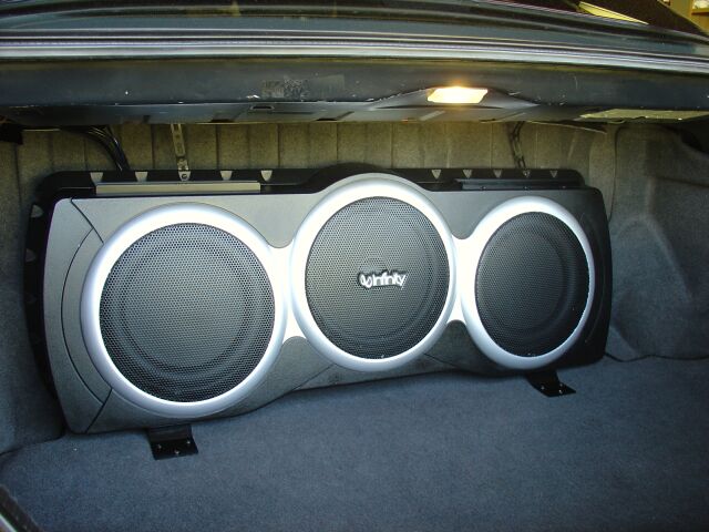

Case in point. I use a Infinity Basslink T, which at its deepest point is 7" and it has a single 10" sub and two 10" passive radiators. RMS power is 250watts. The remote volume control (depending upon the genre of music) is set at about 1/4 of its maximum (in my car), so that translates into ALOT of bass inside the cabin.
Sadly, the Infinity Basslink T is discontinued and I couldn't even find a used one on eBay. Got any recommendations for a similar unit that's currently available...?
:apl:
Infinty does make a similar solution but without the passive radiators. It's about $300. JL Audio also makes a 10" and 12" sub enclosure with an amplifier already attached. I've considered trying out a shallow frame woofer and constructing a box that mimics the Infinity's dimensions. Another idea that won't take too much trunk space is having a fiberglass box made to fit the drivers side well area. A local shop has quoted me around $250 to build it. Not a bad price if you factor in materials, labor, and overall mess created by stinky resin everywhere.
Yeah, I liked the compact (thin) dimensions on the Basslink-T. The others are a bit different, and I'd likely want two of 'em to get decent bass. Guess I'll keep looking...
