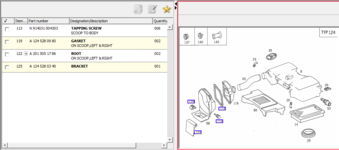

I have plans to install new air intake covers. Previous owner has cut some holes existing parts and mounted them with weird screws. Plan is to use correct screws and all the necessary parts needed.
Can someone confirm or post pictures about the seals between air intake panels and covers? I don't have those on my car at the moment? Then some seal (position 122) is causing problems. According to parts vendor it is not available anymore. Where it should be mounted? Also same thing with the bracket? (pos 125)
What holes should be cut to new parts? Also my headlight wipers were deleted so I don't know where the washer fluid hose should be routed.

Maybe this helps a bit. Item 125 is the clip for fixing the IAT sensor (intake air temp sensor). In case you are missing that clip, look down in the cavity below the ignition coils. And no - you don't get your fingers down there, a stalk mirror and a long flexible pick'er is needed. Or you can access a small cover from the wheelhouse behing the inner fender, it's fixed with a couple of plastic rivets/clips. That cover is the bottom in the cavity when you look from above.
