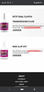

I have NO idea what the base stock is for any Red Line ATF. But I am curious.
Their dual clutch transmission fluid is stated as PAO+esters and it's the most expensive: $20/quart. CVT is stated as PAO only and is $14/quart. No mention of PAO or esters for other ATFs. It could be that D4 at $12.50/quart is group III only? 🙁
I sure hope not! But we'd need to have Red Line tech support confirm...
