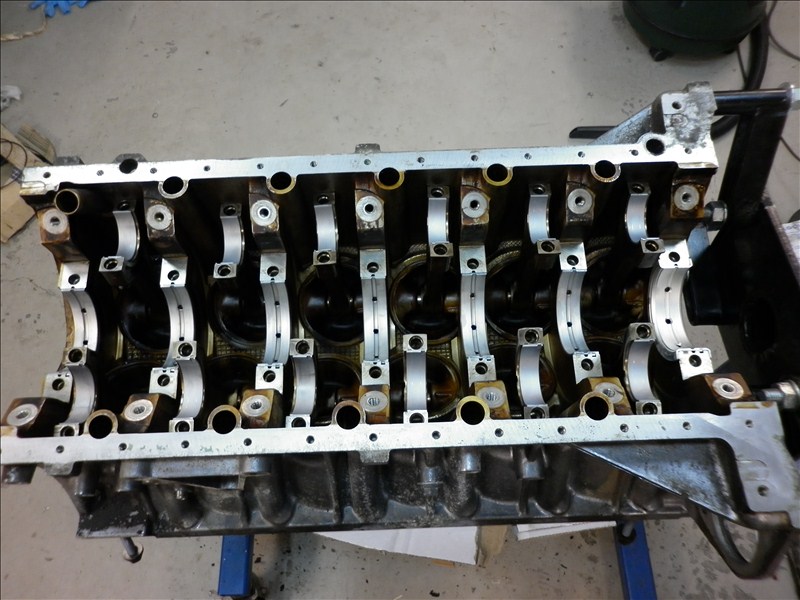

so i took the engine apart aaaaaaaand, let the show begin...
but before restoration i took the crank,,bearing tray/holder and camshafts + all that stuff to minimize the weight when ,, installing for engine mounts fabrication

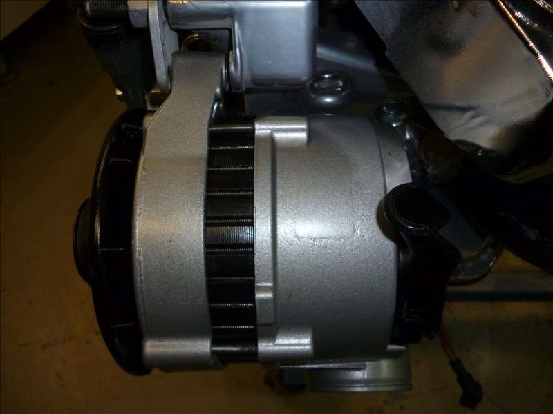

totally overhauled alternator ,

new bearings,, main + conrod
just an useless info Conrod bearings are ONLY by BMW and cost a fortune

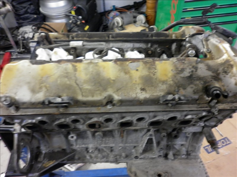

cylinderhead refurb
Sv.H-Motorsport solution,, made by Max Lumens
this is a genius solution if/possible replacement for oem intake gaskets,, you use the oem,, but these are 3mm thick precise cut out of silicone and goes to head and under intake manifold((oem cost the same as a week holiday on a beach))

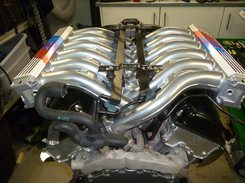

exhaust manifolds were sandblasted and the heat shields........ CHROME :shock: :shock: got lost in Vanity
Most parts were sandblasted and powdercoated,,
lower oilpan and valvecover are black ,,all other parts shadow-silver-chrome ???

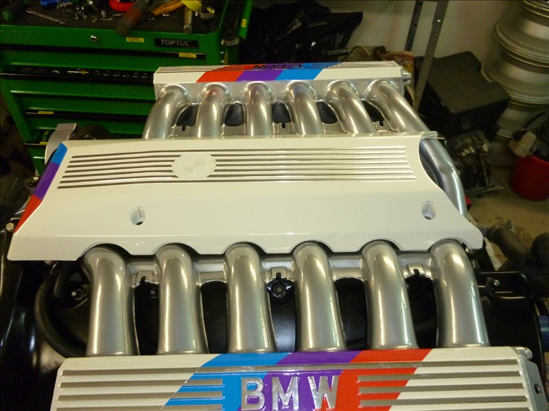

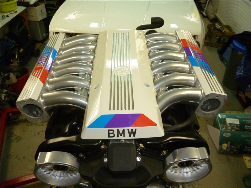

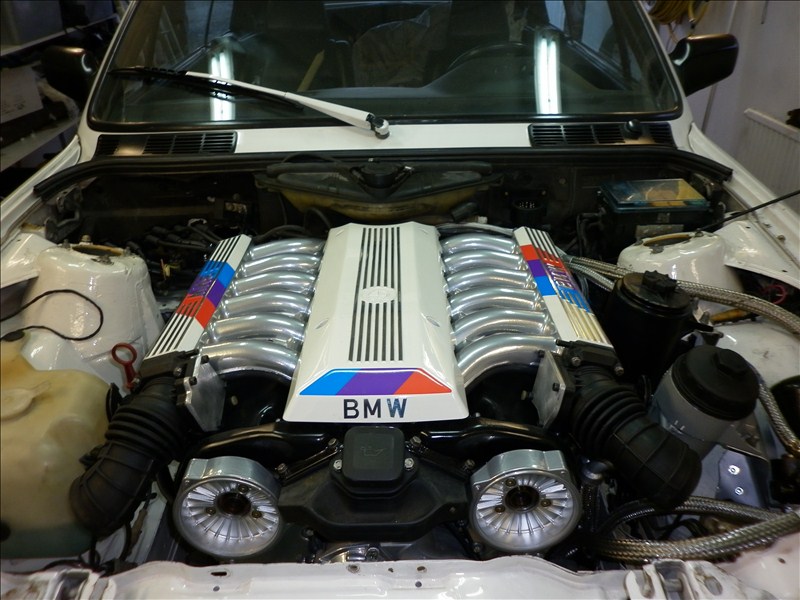

M70B50,,,,,,, 500 horsepower look :lol:
the white color is painted
/// stripes is mine/stolen idea ,,,,,, the chrome stripes are mine idea,, this is all foil

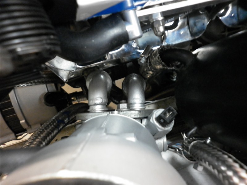

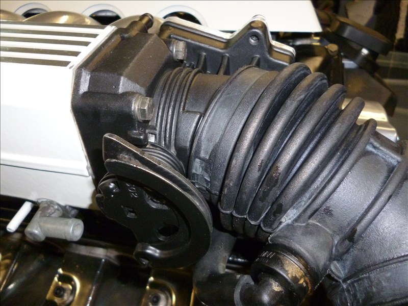

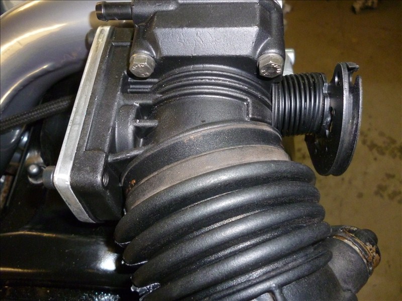

Throttlebodies ????? i took the electric motor off and made them manual

overhauled Alternator,,,,,,,,,,,,,,,€€€€€€€€

Manual Throttle-body

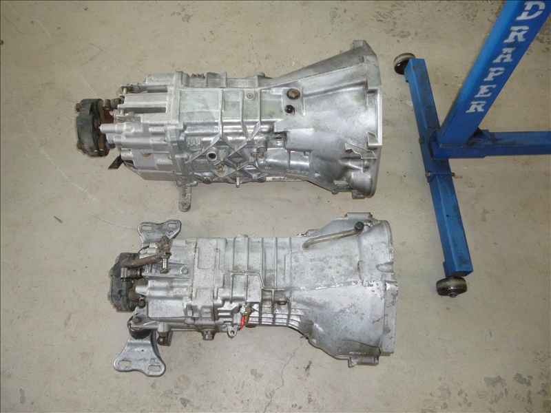

v12 gearbox S6S 560 Getrag on M/S70 , from a UK RHD 850 CSI
ahh, i wanna jump on you
G560 vs G280
N.B G280 is aprox 5cm ((2")) longer vs G260/6 ((M30B35))
N.B.,, G280 is on mounts and oem g280 bracket

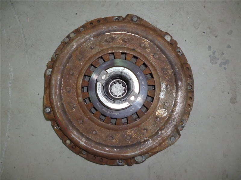

SACHS,,, V12,,,,,,,,,, über über every BMW clutch i have seen so far
Sachs x 2 most likely the 2 titans in each class of its own
B10 BT clutch is the stiffest 240mm i have tried so far vs other 240mm but is made for DualMass flywheel ((Sachs 765 press is also heavy strong and stiff but made for Singlemass))
and then Sachs 280mm V12 clutch made for BMW,,,,,,, pretty much not the same size
the 240mm clutch bearing is almost a joke compared to the V12 280mm :
similair as G420
the shifting arm and selector rod may have to be shortened more or put more lenght in,, i dont know,, the gearbox came out of an UK E30 V12 conversion that was not finished

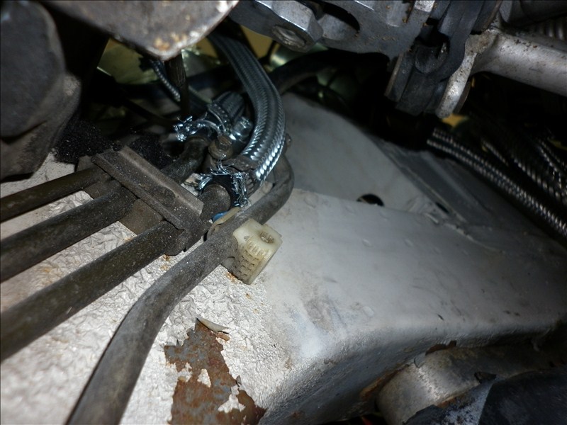

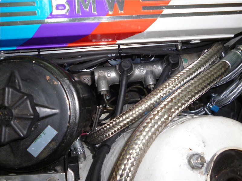

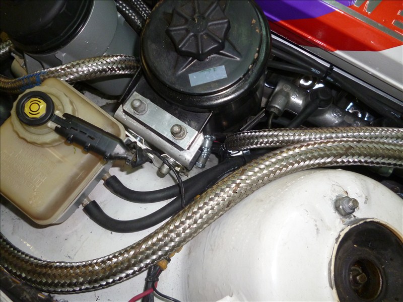

lots of oil lines.....
a) 1 ,,main feed from pump to Accumulator.. pressure
b) 1 from accumulator to mastercylinder feed,, pressure
c) 1 from accumulator to steering box,, feed,, pressure
d) 1 from accumulator to oil carrier,, reverse
e) 1 from mastercylinder to oil carrier .. reverse
f) 1 from oil carrier to pump,, reverse,, big one
g) 1 from oil carrier to steering box,, reverse
got it ???????
all lines are high pressure and covered with stainless steel sleeve
the oil lubrication carrier,, i had to make new lines from flex steel hose,,
3 fuel lines 2 in 1 and 1 reverse

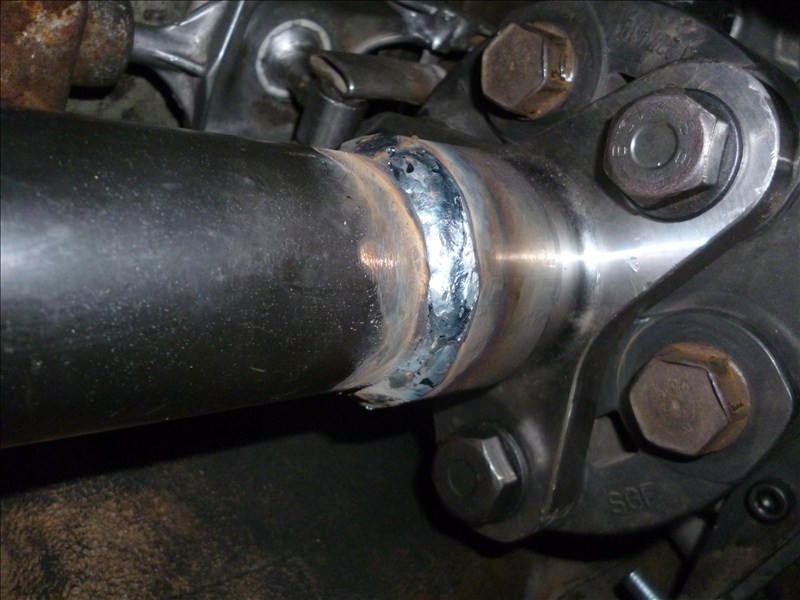

Custom made ,, Guibo end to the gearbox.......... 110mm ((beat that)) made out of solid steel and turned by a lathe

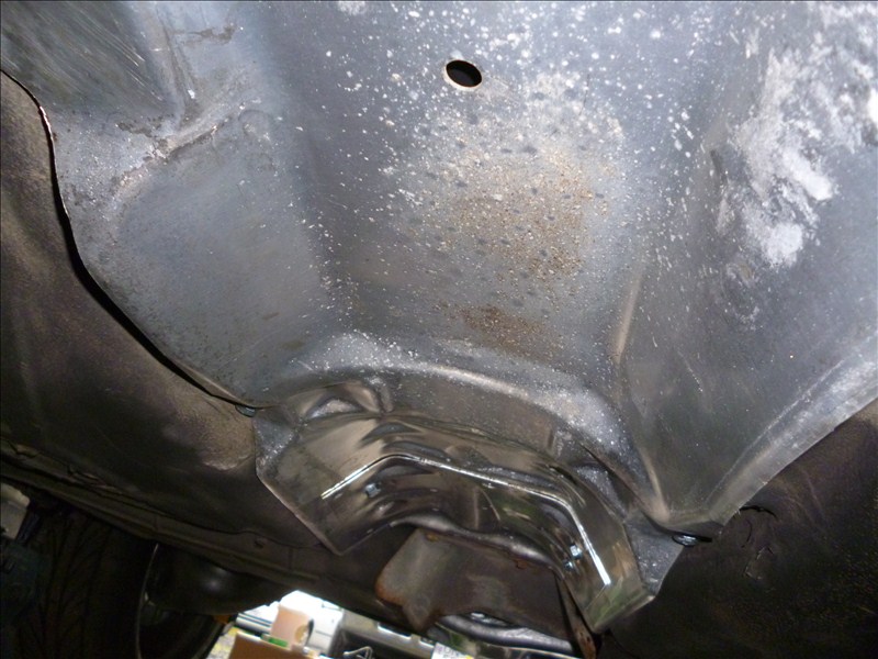

some kind of strenght frame ......... E30 cabrio.......... ONLY i think

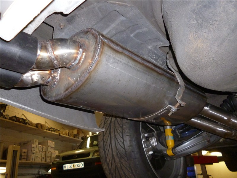

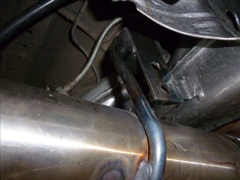

Stainless steel rear muffler,,, designed by my idea,, have the dimension as oem 325 muffler,, got it tigwelded ,, and bended hollow stainless plate for pipe through the muffler
I will use 2 x 63 mm stainless pipes for exhaust

Well,,,,,,,, the exhaust is finally done....... at a hefty price ouich
it was narrow but my man did it well,,, stainless all the way from oem manifold to the end.....
from manifold,, 2 x 42.4mm tubes and bends were used ,, and then in to 63.5mm
4 flange 8mm 316ss were made,, an X-PIPE and just 1 rear muffler + lots of bending and many meters of pipes
tight... right side of the car.. some mods because of the engine mounts
also on the right side,, developed..or designed in that way the starter can be taken out
drivers side.. the steering was the main factor of design
This explain it self 2 x 2 -->2,,,,,,,
and then in to X-PIPE...........
X-PIPE..
WIDEBAND,,,,,,,,
rear silencer
in front of silencer
M70B50,,, V12 oem exhaust tips
And the car on its way to the garage :hihi:
