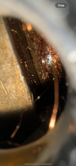

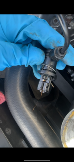

Thought id document this. Yes that is copper wire on my cam and the other half of the sensor is likely in my oil pain i will have to take the valve covers off to remove it asap. But i installed a new sensor and car is back to running normal.
Issues that made me aware was approximately 5 second crank but will always start, Low power and chugging, and i wish i photographed it but the sensor was like how it was in the first photo when i checked under my hood at the gas station.
I was messing with it and in the area the previous weekend as i was aware it was beginning to fail but didn’t realize it was way worse than i thought and i must’ve put the final nail in the coffin without realizing it.
