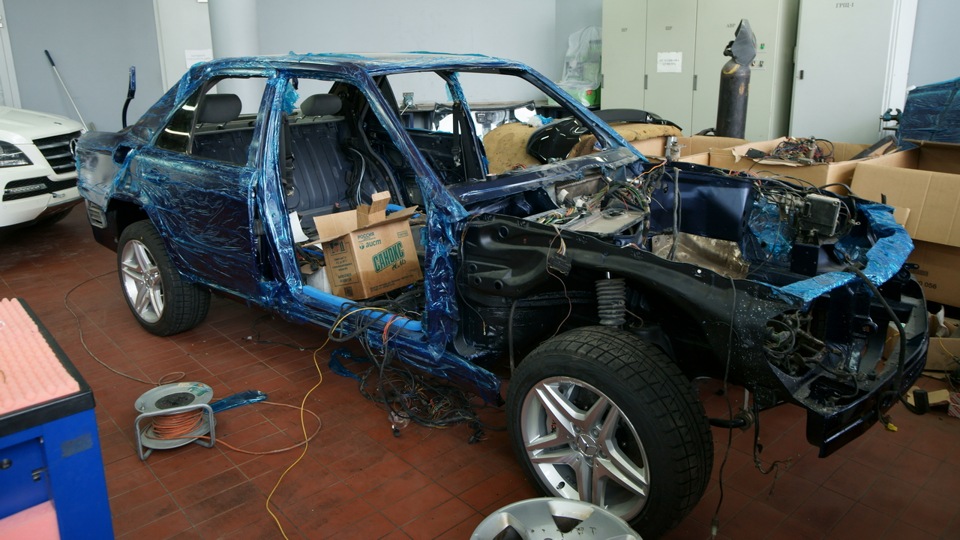

Thought I'd share with the board. This is an e420 in Russia that is being converted to a E500 with an engine+wiring harness from a w140. He decided to put the w140 gauges into the w124 cluster since w124 gauges would not work with the w140 wiring..Also modified the speedometer to show higher speed - 360 (calibrated). Later he's planning to build the engine more and achieve 334 km/h...

Pretty neat project he has there. Shame there is not more detailed info on the gauge build. And also his engine build. Even with 600hp, I think his estimate of 334kph (208mph) is highly optimistic. He's basing that on some crazy low Cd numbers from the Hammer but I don't think he understands how AMG got the Cd that low. I think it could crack 300kph, maybe 310kph. That assumes either 2.24 gears, or a 5-speed tranny (he mentioned a 5-speed trans but didn't have pics).

He also says that the air suspension in the front will allow him to lower the front when running for the record to lower the drag. Also 5 speed transmission(instead of 4 speed on the Hammer), modern tires with lower rolling resistance, better ingnition system than Hammer's...

The 5-speed tranny isn't really required but it does allow use of lower gearing in the diff, assuming 5th gear is an overdrive. Rolling resistance is more of a factor for fuel economy, not top speed runs. I'll be very impressed if he cracks 200mph/320kph. It's not going to be as easy as he thinks, IMO. Hopefully there will be some official recording done via radar gun, timed traps (i.e. Bonneville), or at least a top-quality GPS. Speedometer readings don't count.
