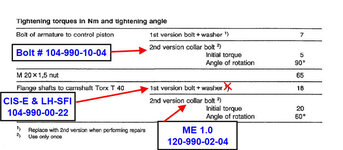

Well shoot. Have you tried a T35 driver? I can't recall if these are T30 or T35. My notes indicate T35.
If you do have to drill... good news is, replacement bolts appear to still be available. Bad news is, they are now 10x the price from a few years back. $28 MSRP each now!!! The later T40 bolt will not fit, there's an error in the FSM.

No threadlock is required nor recommended. The factory bolts have a captive washer, you'll need to try and replicate that setup if not buying new OE bolts. I can't recall if they are a curved/concave washer or flat washer.
