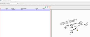

First, my lower crossover connection looks pretty crusty. Diagram for reference. My lower crossover connection is the circled one. Those nuts look like I'll probably be hitting them with an air chisel or something? @kegmankipp suggests a sawzall (or in @RicardoD's case a Milwaukee Hackzall) but I dunno, I mean an air chisel can probably split the nut.

Anyways I am not too worried about the lower circled connection. I am worried about the UPPER connections, the ones indicated by the red square.
