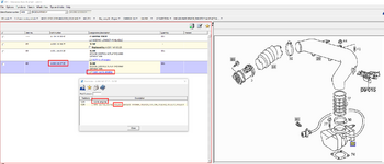

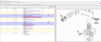

The VIN is a big help! See updated screenshot below specific to your VIN. Your G320 does not have ASR (no code 471 in datacard). Click here to see an online datacard.
The dealer part numbers are correct... however the footnotes change based on your VIN / chassis number. The part numbers differ based on the engine serial (not model year or LHD/RHD). Yours should be 000-141-57-25 since your engine is prior to the breakpoint of #001163.
I believe Kurth may not have an ETA on the shelf ready to ship, but you'd have to contact them and ask. They may need you to send yours in for testing & repair. I believe their base price is only for rewiring and testing. If additional components needs replacement (switches, pots, clutch) the price will be higher.
