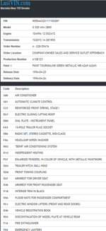

Hi Gerry,
Please see my VIN: WDB46323117105387 to assist me look and pull up the correct Modules that came originally with my Vehicle.
Below is a snapshot of what I could pull up from LastVin.com
