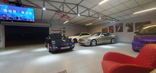

I'm fascinated that people seem, these days, to be real into hexagon lighting. To me it seems like it provides good even light, but blocks EVERYTHING on the ceiling and so you can't hang anything from the ceiling --- like electric drops, hose drops, air hose drops, etc.... ridiculous n'est-ce pas?
It can be squiggly things too...not just hexagon. JLAA, come over the bridge to Marin and check out Club Wheelhouse! Regardless, good luck with the Majal and please post pics once construction ensues!

I thought the Hexa light was good for detailing bays. I converted my pain in the ass Fluorescent lights to cheap ceramic light bulb sockets and put in the flower pedel LED lights that put out 8000 lumens. Work great for my my older eyes.
