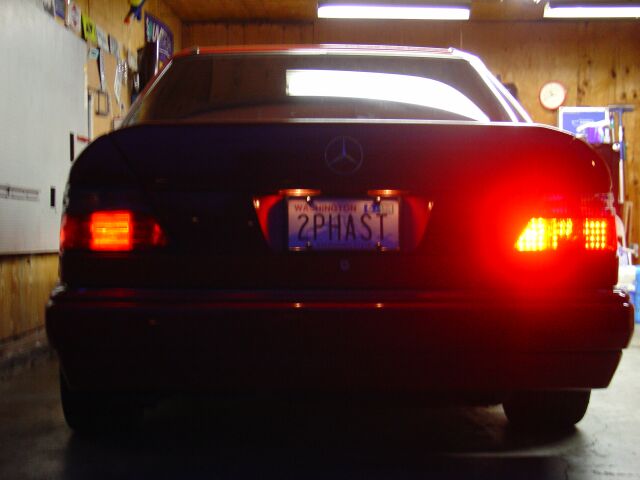

I actually use LED tail lights, which are a complete assembly with LED's, ballast etc. Very, very bright, think Cadillac CTS bright! Turn signals and backup lights use regular bulbs though.
In the picture, standard bulbs on the left, LED tail light on the right

Can you post a reputable brand and source ?
