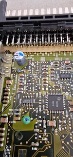

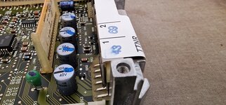

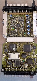

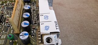

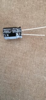

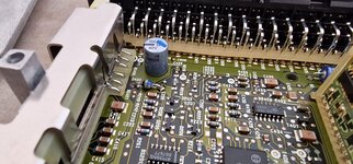

Hi

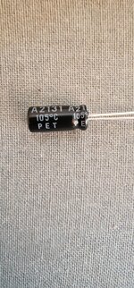

I have bought new capacitor to my 1994 LH module
100uf 50v and 22uf 50v se pictures
The size of 22uf 50v is to small its okay to use ?
The original size from the factory for the capacitor is same
It's safe to use the new I have bought?

Hi
Its safe to use the new I have bought?
Physical dimensions do not matter (unless
It physically does not fit). Only electrical specifications matter.
Does anyone have the right specs for capacitor or link to where to buy
I suggest:
UBX Series Nichicon 100uF 50V 150F - 3 in each LH ECU
UBW Series Nichicon 22uF 50V 135F - 3 in each LH ECU
