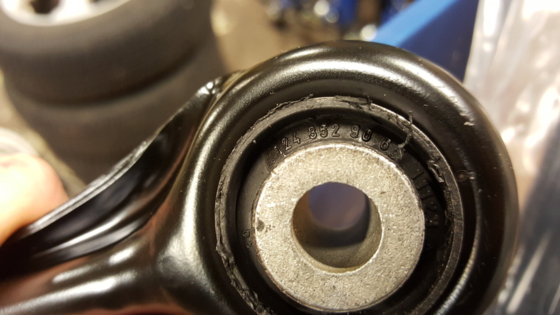

Yes. And Lemforder needs to be dropped off the “approved” parts vendor list to the “caution” list.
I definetly do not agree on the Lemfoerder part of that statement :)If so..you might aswell just drop the Genuine Mercedes parts aswell..cause a lot of them are made in socalled "lowcost" countries aswell.Even the arms from Lemfoerder made in Turkey has Mercedes partsnumbers on the bushings.And alot of parts made FOR Mercedes Genuine..are made in Turkey,,greece,Latvia..and such.
