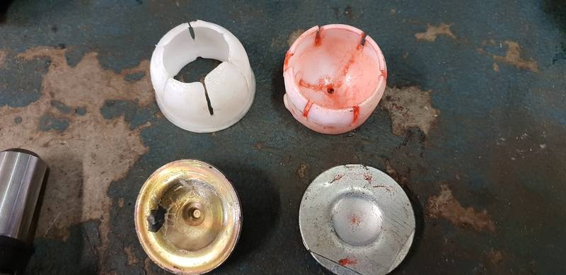

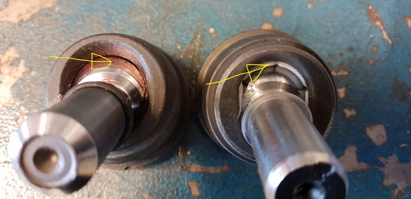

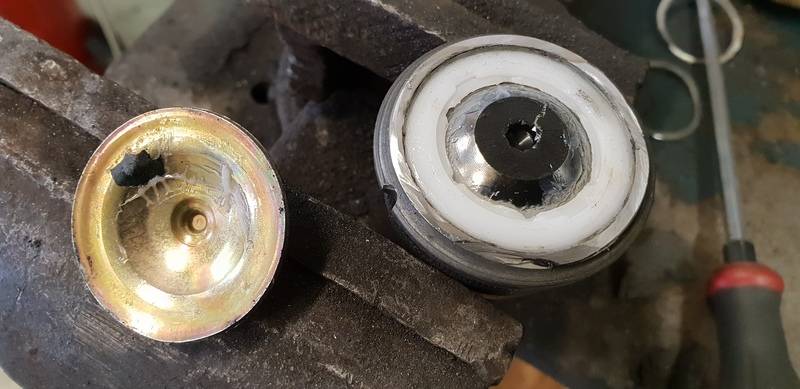

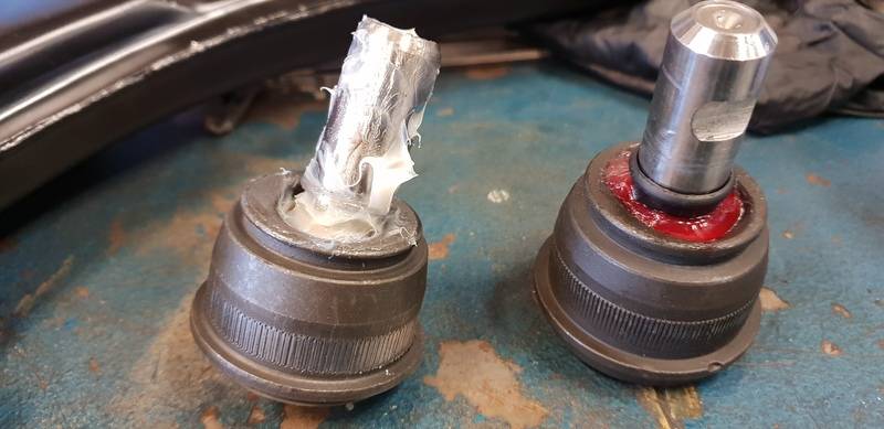

Got my new Lemfoerder LCA"s
And i do question the authenticity of these arms.At least the balljoint...and to some extent the bushings...so what is really left thats Lemfoerder..bummed out really :)
BUT the positive..is that the tolerance issue does not exist on these LCA"s...my ORIGINAL Lemfoerder balljoint fits right in..luckily.
Check out the pics
The logo here IS confirmed a genuine Lemfoerder logo..even though initially i was questioning it looking like this..and not with the "Owl" inside the triangle..but i found out that the L and triangle is a genuine logo.
Lemfoerder?
"Lemfoerder"?
Lemfoerder to the left..and "Lemfoerder" to the right
"Lemfoerder"?
"Lemfoerder"?
Lemfoerder!
Lemfoerder!

Thank you..yes im super exited about this aswell.I just have to get to the bottom of it now that ive started.So looking forward to hearing from them again.
The writing on the bag says "Lemforder " with the two dots about the O...so..as far as the bag and labels go..it is correct.
By the way..ive gotten a tip about the balljoint beeing wrong for this application..and i agree very much with the guy suggesting it.It is of a push load design..and not Pull load design...hence the plastic insert not enclosing the inner balljoint completely up towards the top end of the balljoint housing.That makes perfectly good sense when you look at the two different balljoints.
Here is a picture where it shows clearly..that the Lemfoerder balljoint to the right..has the plastic surrounding the balljoint on top..or towards us..making it able to take the pull force that the balljoint on our Mercedes cars is exposed to.The left balljoint..that was the one that came in the Lemfoerder LCA...does NOT have any plastic support on top (Towards us),making it prone to squeeking/and such.
