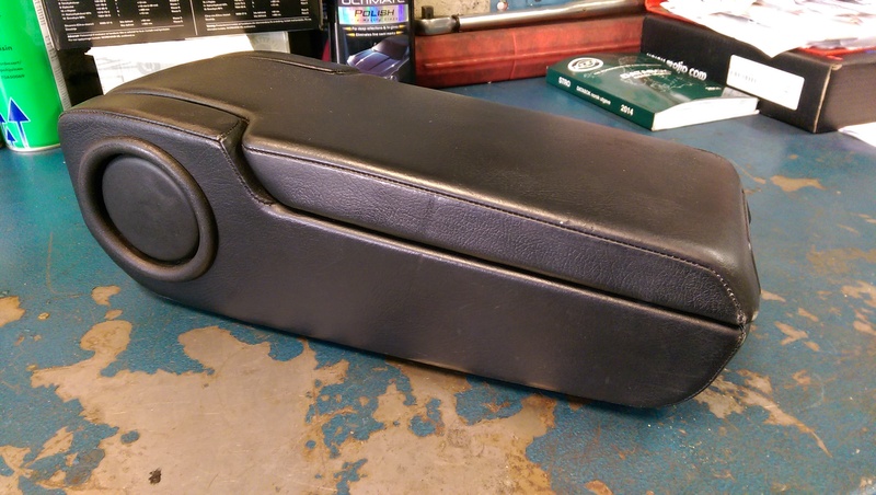

Found this armrest...with storage room /phone holder inside.Been looking along time for one of theese..in the right color..as many of them are the beige or light grey ones..so when this came up..i bought it withouth even blinking :)
So im pretty happy with this :)
Its abit worn on one of the corners..but i consider it soullike wear marks:)...though i will try and freshen it up...or maybe retrim the upper part.
