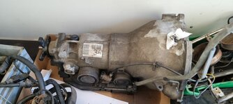

Just found this baby for sale nationally. For a bargain price of 250 dollars .No guarantee for it beeing 100 percent in working order, but the seller i bought it from, did get it from a lady, that did say the transmission was fully working. Came from a 500 SL. Looking forward to take the Pan off, and the primary pump and reverse clutches out for closer inspection.
I also have new genuine reverse clutches etc coming in from Germany 🤩
Eitherway,,i cannot go wrong with it, for such a low bargain pric.🤩

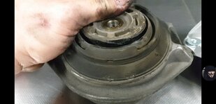

oh yeah, those mounts were TOAST. What was the date code? Original from 1992-ish?
:duck:
:duck:
yeah man,,they are far beyond toast. They are the original ones to the car..so they are from march 91. But i will check the datecode to make sure. I was aware of them beeing not goot,,,as there was an unpleasant shake during cranking the engine,but also noticable shaking engine at idle..and some sound transfer when driving. The engine mount headshield was touching the housing of the engine mount.
