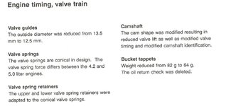

Very intresting but in file M119_1993_update.pdf May be something wrong?

I think from that table from FSM is possibe to calculate lift, but I don't know how.
Add.
Ok I think deeper. We can calculate not in mm(but if we assume it linear prosess we can calculate, knowing that 1993-up is 8.9 mm) but in degree of crank rotation.
for 119.960 it will 180-25+35=190 it mean that from open to close it will 190 degree in term of crank rotation.
for 119.974 for those 1993 up it will 180-33+42=189 degree
8.9*190/189=8.94mm difference is 0.04mm but process is not linear.
Only what I may say is that on 119.960 intake valve is open little longer or little shorter if from close to open.
Add part 2.
I incorect calculate assume that intale valve start opening when exhaust just close
full cycle for 119.960 will 13+25=38 degree and need add 190 from previous from open to close 38+190=228 degree.
for 119.974 1993 up 11+33+189=233 degree.
8.9*228/233=8.7mm we have little less for 119.960 but if we add what mention in file that mean that inlet valve on 119.960 open and close more agressive that on 1993 up.

You cannot determine lift from duration. The only way is to measure the lobes. Also, lift and duration are two separate items... you can have high lift with short duration, or vice-versa.

I fugure out this. but if we watch from airflow point of view they become connected or we may assume that they connected. Right?

gsxr, I figure out your poin of view, but doc say different story. I see only one way to solve this problem, is or find spec or do measure of lobes.

I already told you. Jono measured them. The .960 cams have less lift, not more lift.
.960 intake = 8.6mm
.970 intake = 9.5mm (1992)
.970 intake = 8.9mm (1993-up)
Exhaust lift is less than intake on all three versions.

I measured the .97x cams personally and I stand by the numbers. I received the .960 measurements from Jono and his data appeared valid (i.e., his base circle numbers were extremely close to mine, so I believe his numbers are correct). Feel free to double-check the .960 lobe dimensions but seriously, there's no smoking gun here. MB made minor changes to the cam profiles due to the other changes to the motor (short deck, different intake manifolds, etc). All the 5.0 motors still made between 315-329hp per factory ratings.

This is incorrect. The FSM for the 119.960 AMG 6.0L engine specified "Intake and exhaust camshafts have a modified cam profile." The EPC does not always show all the parts used on early AMG engines:
http://www.w124performance.com/docs/mb/M119/AMG_500SL_6.0L_Intro.pdf
And all this is ok with M119_1993_updates.pdf even more it describe engines from 119.960 and later and dont describe engine 119.97x from 1992.
This document is describing the differences between the 1992 .97x engines, and the 1993-up .97x engines. It is not relevant to the .960 engine at all (or, the later .98x engines, which received different changes).
