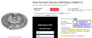

Putting this here for posterity ---- before @gsxr and I forget .....
There are a lot of Worldpac / SSF websites that show interchange equivalents that are supposedly all equal ... but they are not! They show these fan clutches:
SACHS PNMB Part NumberDirection According to Sachs PDF Catalog
2100-027-001119-200-02-22 (210.072)CLOCKWISE
2100-027-002113-200-00-22COUNTERCLOCKWISE
2100-027-031CLOCKWISE
2100-027-032COUNTERCLOCKWISE
2100-027-131CLOCKWISE
Attached to this post is the pdf of the Sachs application catalog.
Note this part of the Sachs catalog that denotes the suffix --- R for clockwise and L for counter-clockwise:
Note that the M119 powered cars need CLOCKWISE fan clutches and the M113 powered cars need COUNTERCLOCKWISE fan clutches if the car is an E430, but need CLOCKWISE fan clutches if the car is na E55. Very confusing!
So I think for our M119 E500E we would want to use: Sachs 2100-027-131.
This means the fan clutch I got from the pick'n'pull, which was installed on an M119 powered 1997 W420, is the wrong fan clutch because this one is a counter-clockwise fan clutch!

Are we saying that for our E500E cars, the Sachs 2100 027 131 (which appears to be available in Europe) is similar in operation to oe, making it the current 'one to buy'?
NO NO NO!! Sachs 2100 027 131 is a clutch that is specifically for the M119.985 engine found in the 210.072 chassis. It will not fit the E500E engines, the mounting is completely different.
To use this clutch in the E500E you must also obtain the mounting bracket used on that engine, which is NLA and not particularly easy to locate used. Jlaa snagged the mounting bracket from a junkyard 1997 E420.
Sachs 2100 027 131 (for 1997 E420, E50, E60) is only available in USA from the Mercedes dealer. Be careful if buying in Europe, likely the same issues apply where you may receive a backwards-rotation clutch just like I did.
