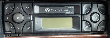

The head unit in my newly picked up E500 is a tape player with boot mounted multi disc unit. I’ve put a picture below.
The unit identifies as Mercedes-Benz Audio 10. Can someone enlighten me if this is a Becker unit?
I have the card with serial and code etc and would like to get it running. There seems to be an intermittent power issue to it. For the first time it came on today asking for the code (which I couldn’t yet figure which buttons to press to correctly enter it - I need to find a manual) - ive only been out about 5 times in the car so I need to remove the unit and see if there is a simple fix to the power issue
all good fun, thanks

So I pulled the radio to find the serial number to find that the sticker has been destroyed but I have a Becker card which came with the car which I am hoping is correct for this head unit
update to this - I found the following website
it’s given me a code 51513 based on the serial on the card but it appears you cannot enter the digit 5 with this particular head unit so I am guessing this card and unit do not match.

This as all later head units use the standard DIN connectors, one for the speaker and power, the second for the CD changer. The flashing red light is an indicator that the theft protection is operational. It is for the radio only.
The CD changer should eject as long as it has power available, which it gets from the radio, I believe. If not, there is a separate four pin connector going to it that provides power.
As this was never the stock radio for your car, I'm wondering if the radio code card isn't for the original Becker radio and not this one...
