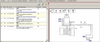

The EPC has 3 listing for item# 303 - Transmission Overload Protector B1 - part# A 002 545 45 14.
The last one with the following footnote:
"Inapplicable to vehicles with catalyst"

-March 2011 - found nowhere to connect vacuum line - either item# 920 or 935 - not sure (see picture) - for the electric change-over valve (don't know what that is..) - quick fix: closed the hose - vehicle became somewhat calmer

Pretty much the idle goes up for no reason, and then probably the ECU gets a mismatch signal between the idle contact switch and the throttle potentiometer readings..?
Something is not adjusting idle stabilization correctly or simply giving bursts of throttle due to an electrical issue. My upper wiring harness is brand new
Anyone got any ideas? Please watch the video. Does it reveal a familiar pattern? Pretty much the idle goes up for no reason, and then probably the ECU gets a mismatch signal between the idle contact switch and the throttle potentiometer readings..? Something is not adjusting idle stabilization correctly or simply giving bursts of throttle due to an electrical issue. My upper wiring harness is brand new.
I'm really suspicious of your ETA, especially since you said it's probably original.
Could a fuel pressure regulator be doing this? ..purge valve? fuel evaporation?
No, no, and no.
I guess the overload protection switch would't be able to cause the situation in the video.
Correct. You either have a bad ETA, or a faulty signal to the ETA (switch on the trans, etc).
Yes, your suspision seems reasonable. I've started to believe the ETA actually could be the culprit after all. One reads it's often not the cause, after replacing it. But taking into consideration the wiring of that ETA has been "fixed" two years ago (which I have no information on except the black electrical tape surrounding the whole harness, and that I've gotten it confirmed by previous owner). And also the very uneven throttle, lack of power on low rpms at times, and the cut off at 4000 rpms, it reminds me more and more of a broken/intermittent electrical current in those wires.
The throttle actuator is only $800 and it comes with 5 year warranty here in Norway.
Besides the NSS will throw codes..
Any final suggestions on other switch that I can check, before I potentially waste a buck or two on a brand new ETA?
