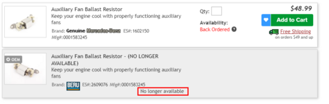

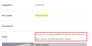

Getting warmer?
Unfortunately back ordered.
Their site may show "back ordered" with no ETA, but it's been NLA since 2022. Doesn't appear Beru plans to make any more of them, especially if MB isn't ordering any:
