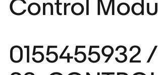

Ah I thought I had read in this forum that would still work.
Any M119 V8 LH module can be used for testing, from any year/model with LH-SFI engine management (through 1995 USA model year).
The M120 V12 modules are designed to only control 6 cylinders (two modules are used to control all 12 cylinders) and these won't work on a V8 engine.
