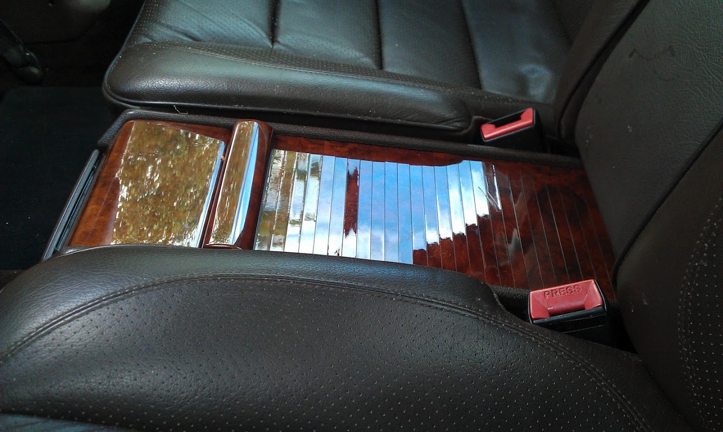

It's getting a bit too dark to take proper photographs, but here's a sneak peak.
The dirty stuff
And it's not just the wood that's dirty!
Cleaned up
Detail
No worries, the person that took of your wood trim is just planning on re-finishing it. In the meantime, it will be a good idea to vacuum and clean around for a fresh new look once the wood is back in place.
Was going to point out the same (needs vacuum) but he has guy called 036 that does this ....lol. JB, get down on your knees and do it yourself, man!
How and what has 036 done?
Well, biggest difficulty is to diss- and assemble those boxes
http://www.500eboard.com/forums/showthread.php?2548-Wooden-Trim
How- good old 3M and AutoGlym as finishing glaze. 80% hand polish, some real deep scratches- polishing mashine, lowest speed. Always check if it´s not too hot. And take your time :) Biggest danger- polishing corners with mashine... Biggest trick- not to brake anything, also by assembling.
I have to say, Jelmer´s trim is in an excellent condition, i would give it 7 from 10.

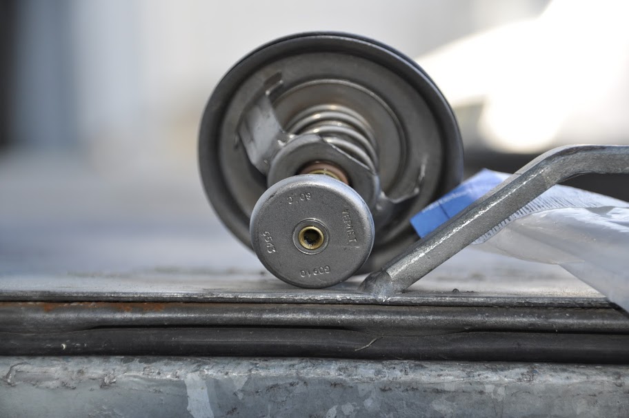

Well, today was 180,000km service-day!
The car passed the co2 test - but just barely, even with the cats on. That might be a problem later on, but for now there are no codes,and all readings seem OK.
The overheating problem has been fixed, as well. The previous shop (which I spoke quite highly of) put in the wrong, aftermarket, thermostat. [insert curse words here].
The right one came out of the car:
No Merc logo anywhere :-/
After exchanging it with a temporary one (from an older V8 model) temps stayed fine, while driving around!
Oooh shiny!
And, who's that behind my car?
:banger:Is that it ? A bloody t-stat? Jeez, after all that stressed it put you through, mate. I'm glad to hear that it's now fixed. That aftermarket one is a completely different design! I tell you sometimes these mechanics don't realise the pain they put us through.
The correct t-stat for the 500E should look like the photo below, same as the one that was in Jemler's car. I think they just used a cheap aftermarket unit instead of OE/OEM. I may have a new OE/dealer t-stat floating around, I'll see if I can get a photo of it.
The t-stat on the left in the previous photo will not physically fit in the M119, that one is for some other engine.
You're right - we didn't end up putting the one on the left in, that was ordered wrong.
I didn't take a proper photograph of the actually opening bit of the wrong t-stat, but it was tiny. Almost half the size of the one pictured here! The temperature was correct, it was simply impossible to move enough water to cool the whole thing :)
A new, OEM one, has been ordered. But I'll put that in when I go to Christian to remove the viscous fan. I decided I still want to get rid of it.
