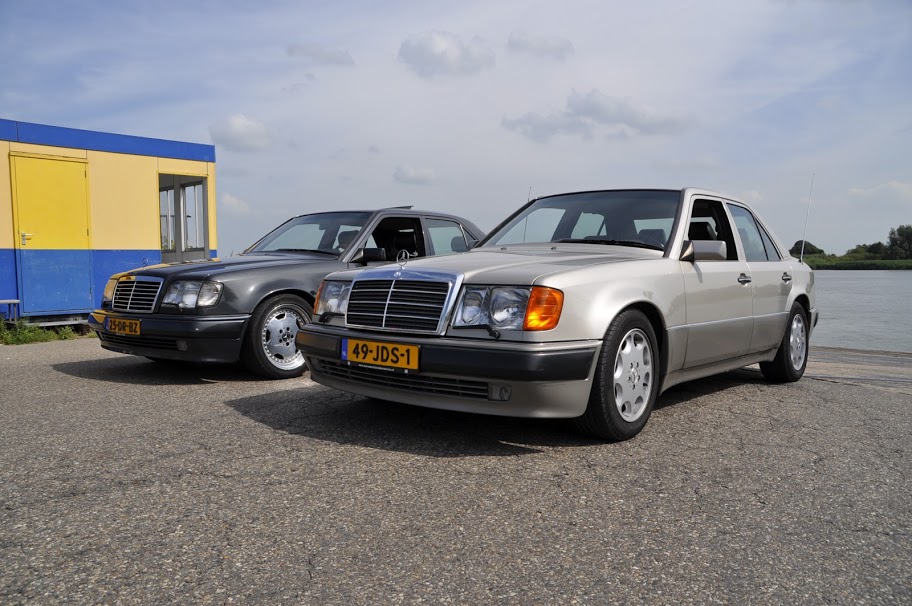

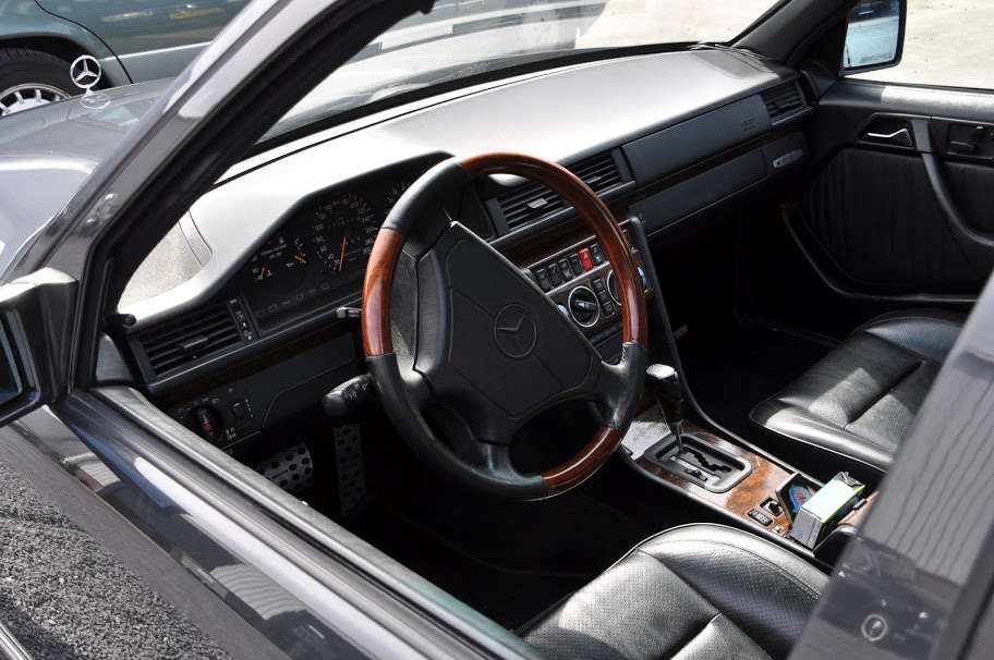

Michel came to visit me at the shop today, we had a quick talk, took some pictures and drove around a bit.
For more and higher res, see https://picasaweb.google.com/104700693364651125477/August162012
What's kinda sad is that when he was driving in third and I was flooring it in second, he drove away and I couldn't catch up. That car is seriously fast. We didn't do a proper race because of his gearbox needing one last tweak, but that will come next time. And I already know I won't stand a chance.
Was a nice but rather short meeting (sorry for that), but made some nice pics of 2 completely different cars in every way. Did you get the sound difference on tape Jelmer?
