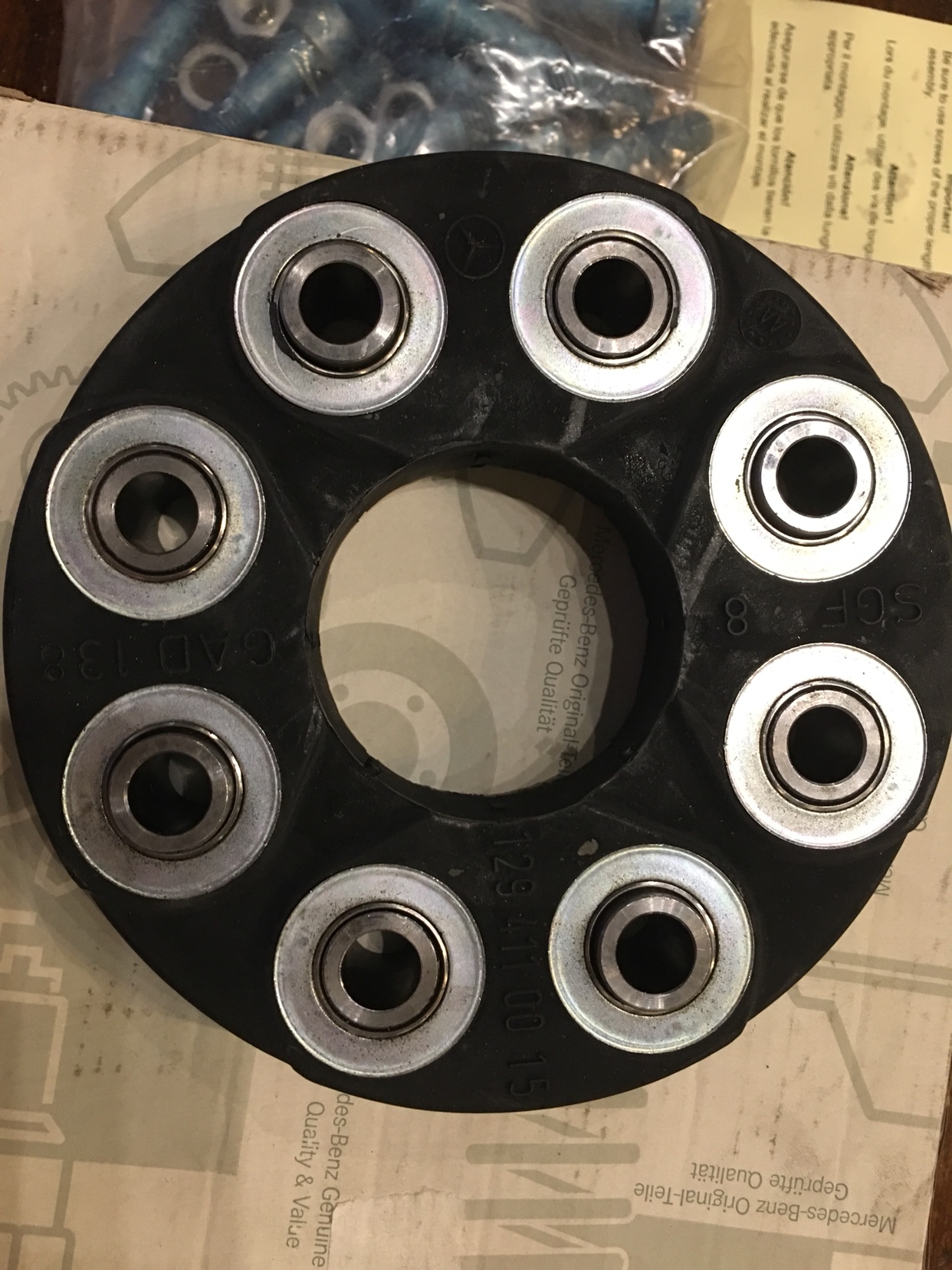

For reference purposes as per EPC, the OE flex disc kits for .036 are as below.
Sent from my iPhone using Tapatalk Pro
For reference purposes as per EPC, the OE flex disc kits for .036 are as below...
Thank you for the visual, Eno, appreciate it!

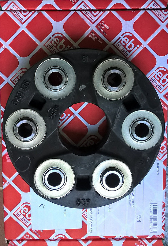

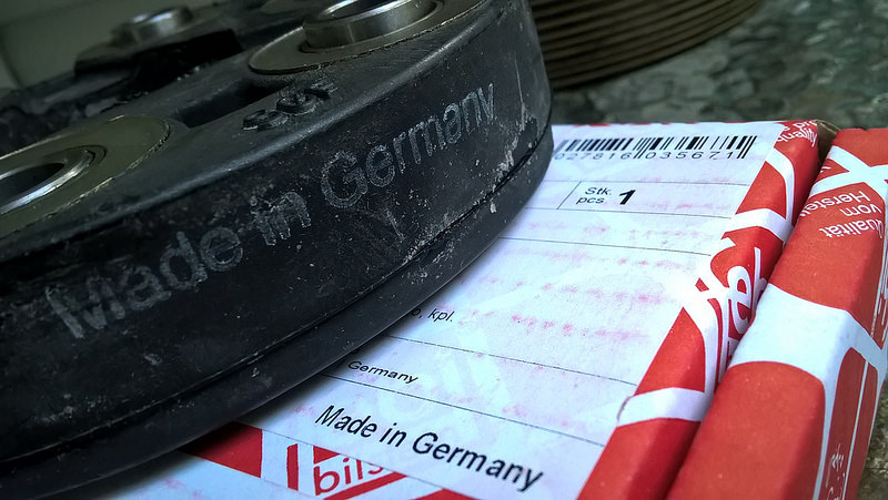

Well, FCP promised SGF and SGF made units arrived:
Going to give these a try on Fri, but from what I hear is not as easy as W124/W201. One way to find out...
