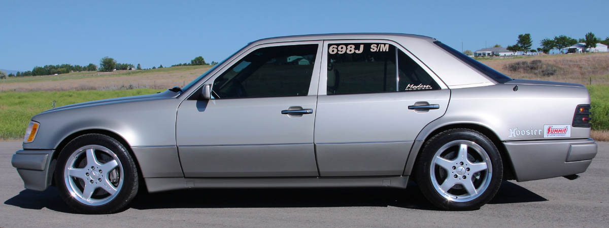

I'm surprised a supercharger fits, and I'd forgotten about Hans' car. I've met him and seen the car. That plus a 6-speed would be quite fun. With those two, you're correct about not needing to lighten so much. Crazy lighter brakes with the lightest wheels possible would help the unsprung weight considerably.

Note that the TGA car in Gerry's photo also has reduced compression ratio (shaved pistons?) which moves beyond the realm of DIY bolt-on, and would drastically increase installation costs. Personally, I'd want to retain stock compression ratio and an otherwise stock engine. Peak power would be less (higher compression = less boost) but installation should be mostly bolt-on.

Yes, I see you have A LOT of personal experience with burdening your vehicle with those speed-enhancing adhesives .....
:mushroom: BUZZINGA :jelmerian:
LOL. Yes, yes I do. That's my wife's race car, btw. The window decals are required for competition, the rear fender decals are NHRA contingency decals (as in, cash payout for either a win or runner-up at divisional/national, NHRA-officiated events). The only "decorative" decal on our cars is the small one in the rear door triangle window for our club, which won its third championship this year (my wife was the club points leader, btw... also had the most individual points of anyone in the entire Club Challenge).
That said, the rear decals, two per side, add up to a total of +4mph. Easily.
:wootrock:
