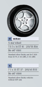

What do you think of these wheels?
Gmach
Can't find a set of 1244010302 monoblocks for the 400E but came across these.
What do you think of them on the W124 ? Offset is ET41
Someone else found those recently. They were an optional accessory wheel offered for the W202 and W210. Might have appeared in a recent BaHaT auction? Yes, they will fit fine, if you don't mind the appearance.
However, they are not Monoblocks, and not AMG. Just plain old Mercedes wheels. The MB name is "Mirac".
Ask for photos of the back side showing part number and sizes. They were available both in 15x7.0 ET37, and 16x7.5 ET41.
