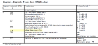

However, once again I had an ASR error, but this time the error code was 009, which I had never seen before.
This error code seems to be a safety relay and I exchanged emails with Don Roden and he said it was probably the E-GAS module. I was going to report the problem here when it was resolved, but then the error did not occur at all and I completely forgot to report it.
Don Roden is a great person to deal with and answer questions.
If fault code 009 was on the ASR module (pin 6), that is related to the ASR pump itself: "ABS/ASR hydraulic unit, right rear axle solenoid valve (A7/3y4)"
If fault code 009 was on the E-GAS module (pin 7), that appears to be "Vehicle speed signal (VSS)"...?
I doubt either would be related to the E-GAS module N4/1.

I am using star in Japanese and it is an image from the internet but this error.
I looked at the efp section of my code table and it says safety relay for efp/tpm/llr control unit (N4/1).
Ah, interesting. If there are no problems with engine operation or driving (normal power, no limp mode, etc)... I'd ignore the code.
The WIS documentation is less clear on E-GAS fault 009:
