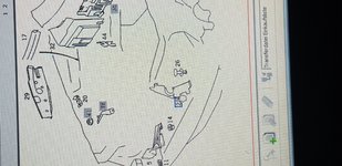

Guys, I was browsing the EPC for some small bits and pieces and came across these cover plates who will block the passage from the radiator to the engine air intakes behind the head lights. Haven't seen them on my car or might have lost it during the repaint somewhen in 2001.
Below is the pic (mouse cursor is pointed on it) , let me know if you have them in place and if so please post a photo.

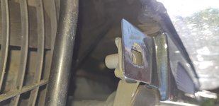

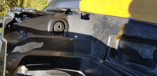

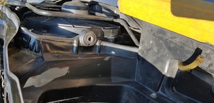

Installed the panels today. Head lights have to come out for this work. With these installed the air gets directed better to the radiators instead escaping to the left and right intake funnels. I have small air intakes in the head light panels for the engine anyways.
6x clips are required, the plates are 1907 and 2007 part number ending (last 4 digits)
