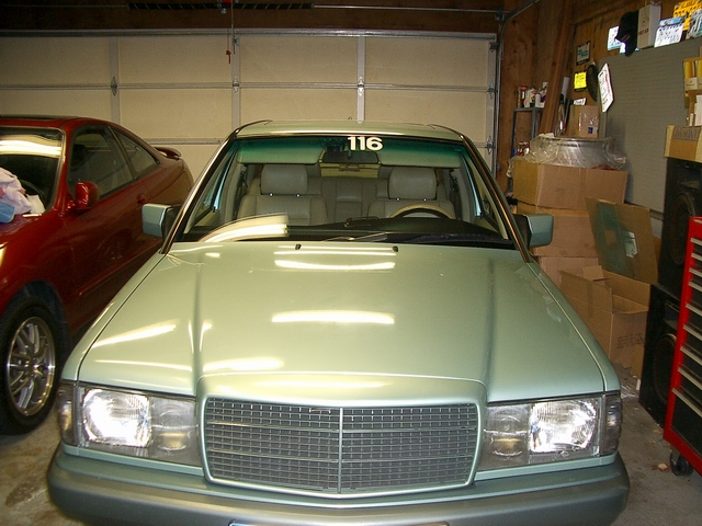

I did this on my 190e. The problem with the stubby mirror (on the drivers door) is that the size coupled with the convex glass limits your viewing angles (creates a blind spot) and distorts the distance of vehicles. I had to install a blind spot mirror to help with the problem. While I liked the symmetry of the two mirrors, the visibility issues would prevent me from doing this mod again.
