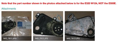

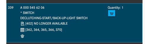

As noted in the HOW-TO, the neutral safety switch part for the 6-cylinder M104 cars (000 545 49 06) is NOT the same and is NOT compatible with / interchangeable with the NSS for the E500E and other V-8 models (000 545 62 06). The switch as used on the V-8 cars has an extra pin in the flat connector, and has extra functionality that the six-cylinder cars' NSS does not have.

MB dealer sites in the US are showing this part as available for $90-100, although MB's Classic Parts site is not showing that this NSS for the V-8 cars is currently available. It's important to note that the US dealers parts catalogs are NOT reliable and should NOT be used as an indicator of availability. The MB Classic Parts site is much more accurate.
MB's ISPPI part system is also showing that this part for the E500E and V-8 models is NLA.
The switches are available as MB parts from aftermarket dealers, and they are also available as a quality (OEM) part on the aftermarket, at least here in the US. The US company "FCPEURO.com" is selling the genuine MB part for the clearance / discounted price of $80, which is a great deal. Other companies such as AutohausAZ also have them.
So, you could order from the US, or you could try to find a new MB switch on European eBay if you need something closer to home.
P.S. I re-iterate my advice as noted in the HOW-TO, for EVERYONE on this site who is a long-term owner of these cars:
and
