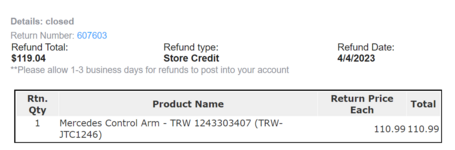

The TRW lower control arm probably is no good. I can hear some popping sound coming from the front driver side again. Not very loud as before but it is there. Rolling down the window, I actually do not hear it as distinctively but with the window closed, the pop can rattle through the car body and I hear it more clearly. It is like my body in the morning when you stretch and twist, you hear some pops from your joints.
I exercised the life time warranty of FCP and get a different one, hoping the quality is better. Hate to do the job twice.
The way FCP's life time warranty works is that you have to place an order of the same part. After the part is shipped, you then file for warranty claim. I never claimed before despite purchased many parts from them. Will see how the process goes.
As the part failed within one month, I called FCP and they sent me a return shipping label. Therefore, the return part is no longer an issue. Just wait for the new control arm to arrive.

Yeah this is so frustrating. I’ll have to see if I got these from FCP or if I went with Rock Auto or Auhohaus AZ when I get some time to do them again. I’ve got a lot of home projects this year and we are taking a 3 week trip to Utah this summer so I might end up parking the car under a cover in the garage for a few months 🫤
Received confirmation from FCP that they have received the returned TRW control. I got a refund but in store credit. I guess I don.t truely get my money back with their life time warranty. You just give them more and more money, pretty good business model if you ask me.
It probably saves them some hassle with regard to paperwork, and also they don't have to let go of precious cash. Win-win ... for them. Maybe not so much for the customer.
So you have to return the failed item first, before ordering the replacement, to not end up having paid twice with a store credit?
:confused:
FCP adjusted their warranty policy last fall. I've been using them for the past 4-5 years for any parts that I plan to replace for my daily driver (fluids / filters / suspension components / brake parts / etc)
Flow as it sits now:
Buy Original Part from FCP For $XX
Use part until it fails
Buy Replacement part from FCP For $XY (Price could be higher or lower compared to initial $XX)
Replace part on car
Ship replacement part back to FCP, Get refund of Replacement Part cost of $XY (If price has increased / decreased, there can be a delta between $XX and $XY that does not have a full 1:1 in price to original purchase)
Refund is now primarily store credit.
I haven't adjusted my buying habits due to already having most maintenance items covered by their lifetime warranty, but I have noticed a general 5-20% increase in prices over the past ~8 months or so. This follows current inflation paths, but looks like they are padding their price a bit knowing people are using the lifetime warranty.
FCP adjusted their warranty policy last fall. Ive been using them for the past 4-5 years for any parts that I plan to replace for my daily driver (fluids / filters / suspension components / brake parts / etc)
Replace part on car
I havent adjusted my buying habits due to already having most maintenance items covered by their lifetime warranty, but I have noticed a general 5-20% increase in prices over the past ~8 months or so. This follows current inflation paths, but looks like they are padding their price a bit knowing people are using the lifetime warranty.
What I did was to return the failed part (via order number) and get the store credit, after which I purchased the replacement (warrantied) part.
