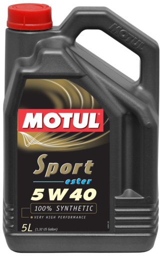

Found a new Motul 100% synthetic Ester called Sport 5W40.
Any thoughts on this?
Photo: https://s3-eu-west-1.amazonaws.com/...cture_1s/36603/double/59951_5L.png?1477662874
Technical Sheet: https://s3-eu-west-1.amazonaws.com/...ets/81777/Sport_5W-40__28GB_29.pdf?1492017750
Rated for API SM, HTHS at 4.0 mPa.s, looks like a 300V for the street, above 8100 X-Cess and below 300V.
This could be the 100% Ester that I’ve been waiting for to replace 8100 X-Cess 5W40.
Any way to determine if this would be good for M119/M113, or find out the ZDDP or Moly amount?
The most interesting thing is that Motul took it off their website and I can’t find much discussion or information on it, not sure what to make of that.
It sure looks good on paper. Any reason you don't want to use the 300V?
It should be fine for M119/M113. Only way to find out ZDDP / moly levels is to get a VOA. If nobody has posted one on BITOG or similar forum, you could buy a couple jugs and send out a sample for VOA to find out. Since it's SM rated, I suspect the ZDDP levels might not be great, but that is less of a concern on M119/M113. (The M117 needs lots of ZDDP due to the old-school valvetrain design.)
Huh. That IS interesting...
:scratchchin:
I racked up on the Motul 8100 X-cess as it was 229.5 approved and it has been on clearance for $33/5 liter bottle. I've been in the threads digging an ppl run 229.51 like Total 8100 0W30 see a couple miles a gallon increase but their iron content shoots up in the oil analysis. I think the 229.5 is the perfect world before recycling became the norm with "energy efficent oil".
Just looked up the Motul Sport. I doesn't suppose to be state-side till March or April.
