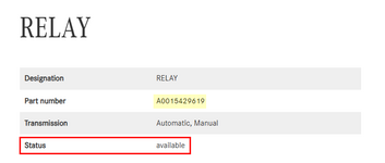

Hello- I have been trying to source a new fuel pump relay and looking for information in finding the FPR for the M119 engines.

The fuel pump relay for the W124 V8 models is a standard, fused 30A relay (usually green, sometimes silver). This relay almost never fails.
What is the problem with your relay? if clicking, that's the LH module causing the problem, not a faulty relay.
