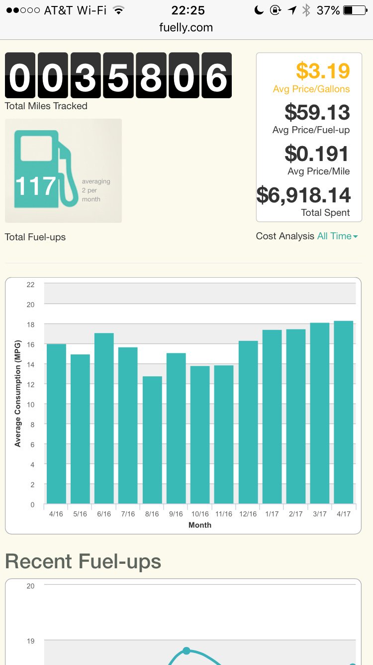

I've just gone through my first full tank of fuel since the odometer gear replacement. This tank was mostly my standard commute which includes some stop and go morning and afternoon traffic, plus 60 to 80 MPH bursts. There was also a good 100 miles of no traffic highway driving. Anyway, as expected MPG is back to normal, if not a little better, at 18.1.
[emoji3]
Great Glen! Let us know when you do a longer highway tour without much braking if you can get back to the 22-24 mpg (summer) standard that I was used to with this car - just curious. Winter was more between 20 and 22mpg
Well as of today, I have owned this car for 4 years! Hard to believe how fast time goes by. Here are some fun numbers.
As of the 14th of January, I have:
- filled the tank 107 times
- driven 32,506 miles (this includes the incorrect mileage from when the odometer gears were broken)
- average MPG: 16.6 MPG (this includes the incorrect MPG from when the odometer gears were broken)
- total gallons of gasoline consumed: 1978.95
- average price per gallon: $3.22
- total spent on fuel: $6402.45
Mileage as of this moment:
As my daily driver, it continues to run great and has never let me down. With all the rain we've had this past week, I'm reminded why I love MB's so much. Even in bad weather they just feel so safe and confidence inspiring!
