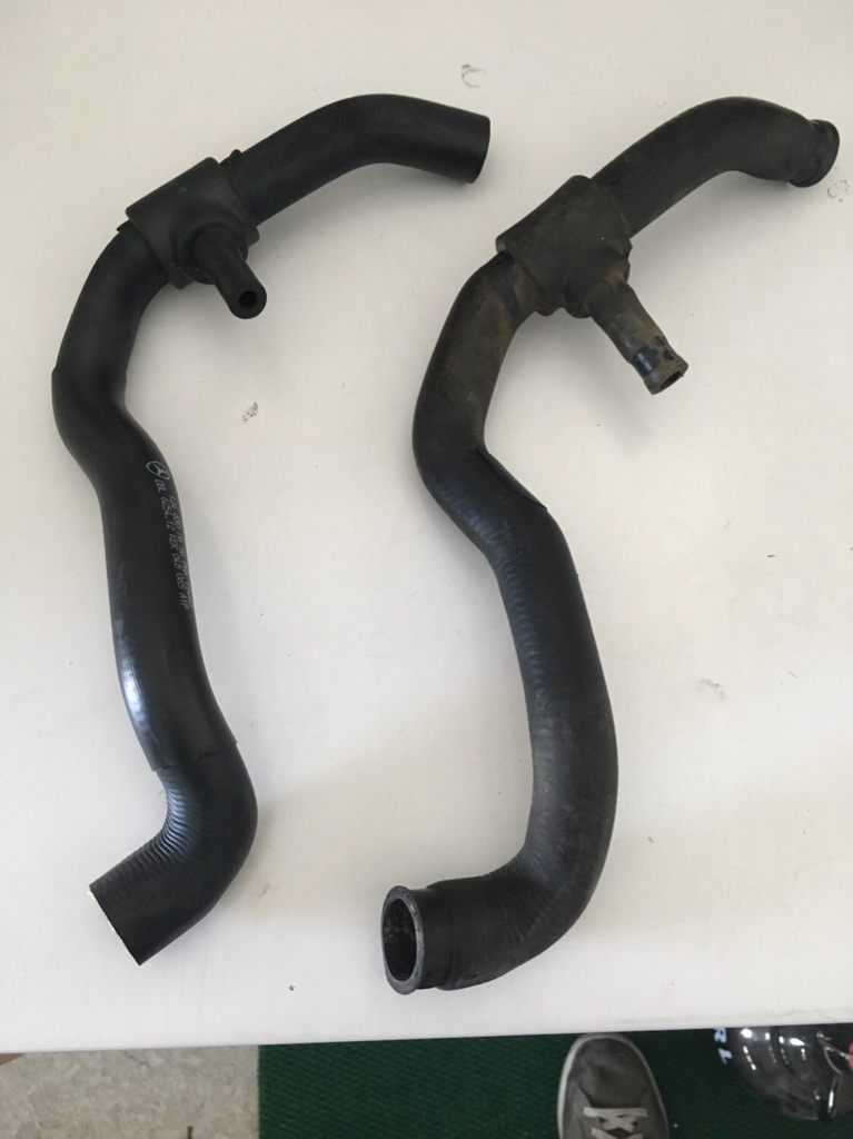

We've been experiencing a heat wave here in southern California. Even on the coast we've had near 90F temps and high humidity giving the cooling and a/c systems a good workout. Being summer and my son home from college, we play musical cars; my son using my wife's car and the high miler going to my wife. So the other day, she calls to tell me the coolant light has come on. Car is not overheating so I tell her not to worry and just get home as soon as possible while keeping an eye on the temp gauge. Thankfully, she made it home without issue.
After getting home from work, I verified that coolant was definitely low so I top it off and took it for a short drive. Turns out the left side heater hose has failed, there's a fine split in the hose right behind the head. I'm relieved it's a relatively easy fix and I even have both right and left hoses in inventory...well, almost. I had hoses for my silver car which is also a '94 but was made a few months later and the driver side hose is a little different and not interchangeable. So, I had to order the correct hose which should be here tomorrow. The right side hose fit fine. I'll post a picture of the failed hose later as well as the difference in the hose designs.
Here’s some pix if the hoses.
Left = new
Close-up of the split in the hose:
Comparison of the two styles:
