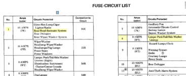

Per the threads above, please remove, inspect and replace the requisite fuse (#9?).
I don't think Fuse 9 is involved at all.
ETM shows fuse 8 for the parking/marker lamps. Rear headrest switch is fed by fuse 1.
I still believe Fuse 9 is a player in all of this.
Would hardly be the first time that the factory schematics do not reveal the true interconnectedness of the various systems emanating from and through the fuse box.
“DTDT” trumps all…
